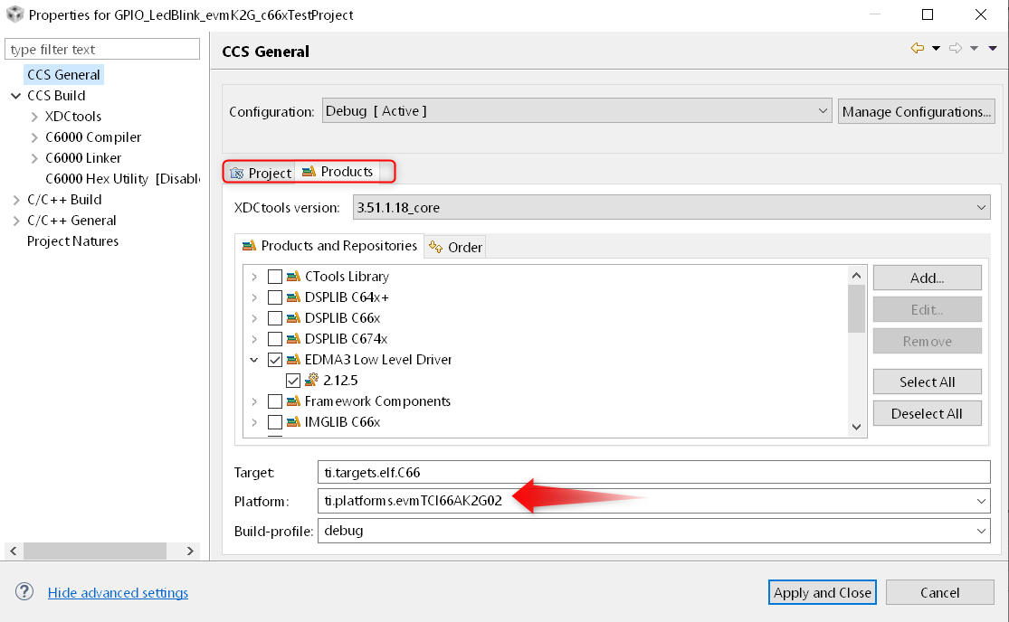

Hi
I have set ti rtos clock ticks to 1000 us so 1 ms. Waiting 10000 tics ends up taking 20 s so tick ends up being 2ms. Where things could go wrong.

    //GEL_TextOut("PLL has been configured (CLKIN * PLLM / PLLD / PLLOD = PLLOUT):\n",,,,,);
    GEL_TextOut("C66x PLL has been configured (%f MHz * %d / %d / %d = %f MHz)\n",,,,, CLKIN_val, PLLM_val, PLLD_val, OD_val,(CLKIN_val * PLLM_val / PLLD_val / OD_val) );

  • Tommi,
    This is a common issue observed with TI RTOS code when the CPU frequency expected by SYSBIOS doesn`t match with the physical PLL setting. If you look at your project settings, you will notice that the platform setup looks like following.
    The default clock setting assumed by SYSBIOS is provided in the platform files specified in the following location:
    bios_6_7x_xx_xx\packages\ti\platforms\evmTCI66AK2G02\Platform.xdc
    The Default clock rate  for DSP in that seems to be set for 1220 MHz which is nearly twice the speed of 600 Mhz that may be set in GEL file.for the platform sets up.
    The clockrate specified in platform can be over riden from the BIOS configuration (.cfg) using the following:
    var BIOS        = xdc.useModule ("ti.sysbios.BIOS");
    BIOS.cpuFreq.lo = 600000000;
    The other thing that may be impacting the clock set is that the timer64 setup. If you look at the device clocking on K2G the timer is clocked using CHIP_CLK1/6 which is MAin PLL/6 = 100 Mhz.  BAsed on platform setup it will be 1220/6 =203 where as physically in the SOC it is 600/6 = 100 Mhz
