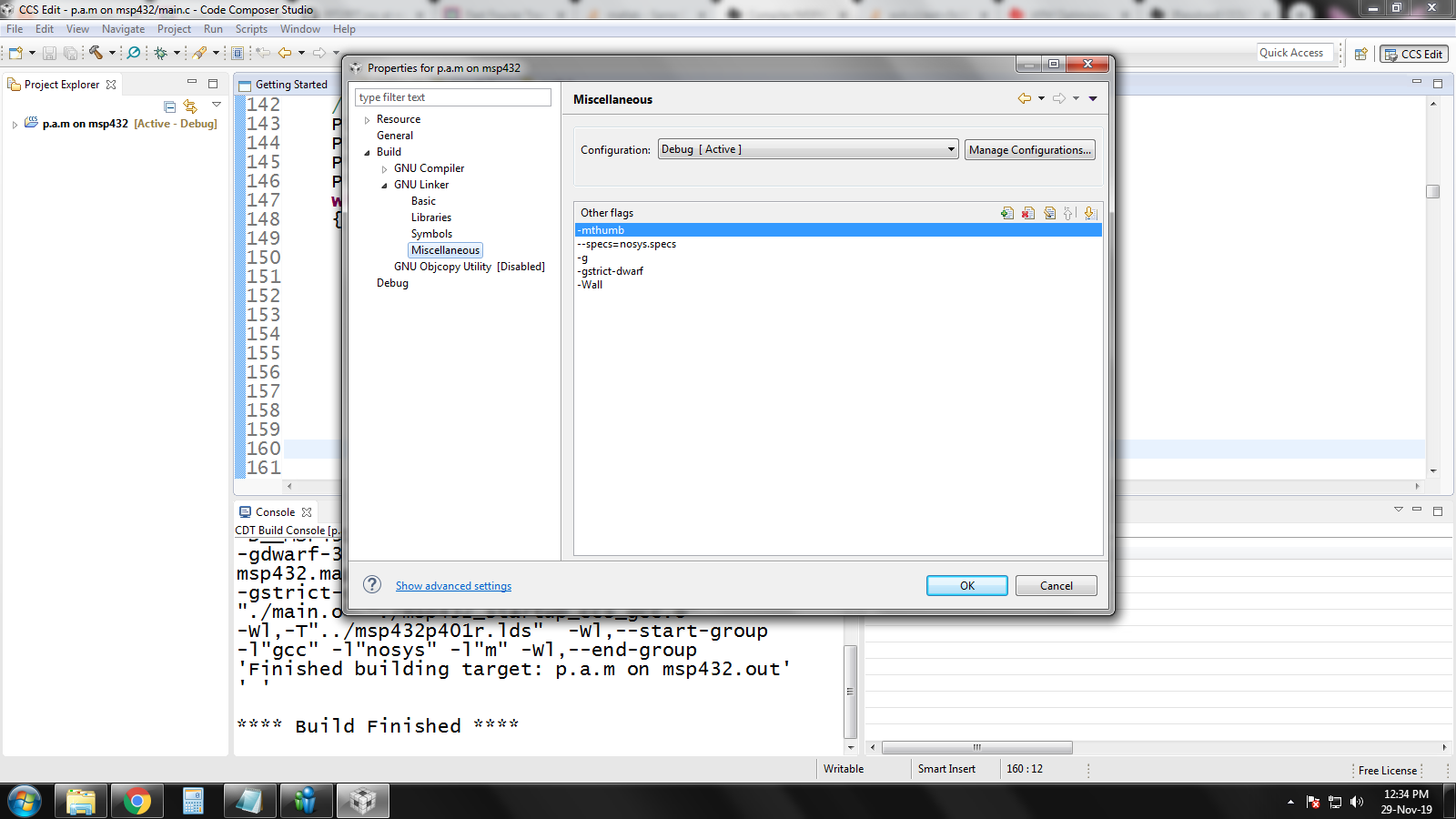

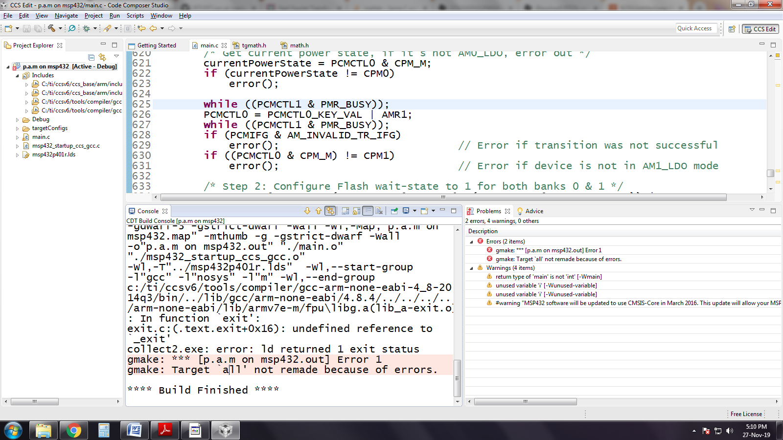

I presume you have based your project on an example from TI. Where does this example come from? That will tell me which experts I need to contact.
In the meantime, here is something to consider. According to this discussion on Stackoverflow, you should use the linker option --specs=nosys.specs.
Thanks and regards,
