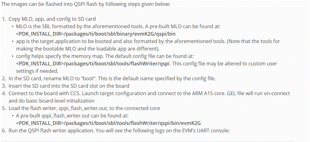

CCS/66AK2G12: how to run the QSPI Flash writer in flashing procedure
Part Number: 66AK2G12
EVM: K2GEVM.
Tool: CCS v9.2.
SDK: - ti-processor-sdk-rtos-k2g-evm-06.00.00.07-Windows-x86-Install
I have followed the above steps for flashing the images in the EVM board. I am facing issue in step 6 I don't know how to run the QSPI flash writer application.
could anyone please help how to do it and it is CMD file.
