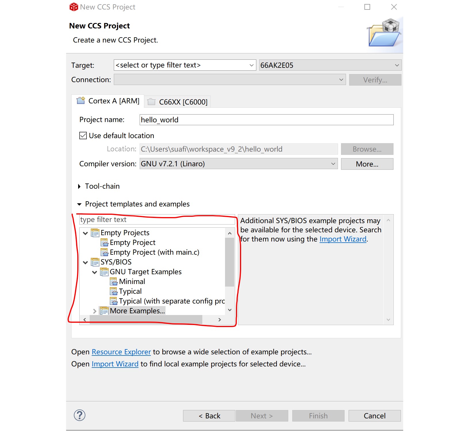

  • Hello, Ki,
    I have read the reference given by you, and when I built the  new project, I couldn't find the " hello world  " example, it is shown as follows:
    Is it the version problem, the ccs version I use is ccs v9.
    Yes, I believe recent version of CCS have the template removed.
