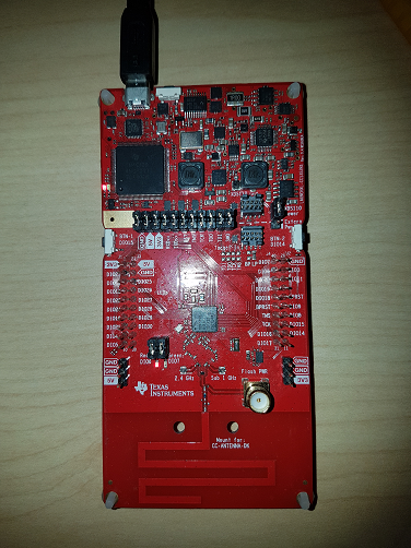

i just buy the LAUNCHXL-CC1352R1 like 2 weeks ago, and also it´s mi first time with texas products. So i was triying the ccs examples codes specifically the EasylinkTx code.
I was really interested in the current consumption of the board when the launchpad was transmitting and reciving information, so i start to know how energytrace works.
When i try with energytrace++, the problems began because i didn´t realice the board need to have the 4 jumpers connected (Jtag 4 pins), so i fixed the problem connecting all the jumpers.
Later i read the Measuring CC13xx and CC26xx current consumption report from texas instrument, specifically the energytrace part, this is when mi problem start.

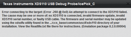

When i connect the board to program the rfpacketTx example like the report says the CCS9.1 start with this:
i know this is a old problem, but i try the solutions and no one works
i mean i try with uniflash and shows the same code error.
My first Question is What i have todo with the board? i mean when i use uniflash i have to remove all the jumpers?
and i try with the xdsdfu and shows 0 devices detected
i can´t get and external debugger, but i have J-link edu mini is there any chance to recover my launchpad?
i try to program the bootloader but the j-link programmer didn´t recognize the MCu
and my final question is can i programm the bootloader with other launchpad?? i have the CC1350 launchpad
