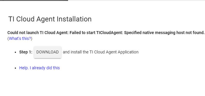

I am exploring on GUI Composer feature in CCS. I want to connect my hardware (TMS320F28335) to GUI Composer.
I followed all steps to create application in GUI Composer. I have installed  TI Cloud Agent still it is asking me to install the same as shown below.
I checked the help it is saying to change proxy settings. I am not getting how to do that.
Another thing is with GUI Composer it is not showing XDS510 Emulator option when we try to connect target board(TMS320F28335).
Is that not supported by GUI Composer?
Please help with the issue.
Namita
  • Namita,
    Please check the troubleshooting tips in this page: http://processors.wiki.ti.com/index.php/TI_Cloud_Agent#Troubleshooting
    For the proxy, you may need to contact your IT department to get the correct settings.
    Also try Firefox browser to see if that works.
    If you are still having issues with both browsers after checking proxy, then please capture TI Cloud Agent logs as described in the above page and attach them here.

  •  Thank you for your support and reference documents.
    The issue is resolved. I tried system login using Admin user it worked.
    I was previously using normal login.
