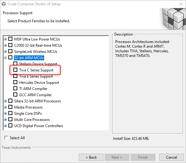

    Additionally, just to provide more context, we are attempting to set up a CCS dev environment for integration with our TIVA development board. The CCS that we are able to run from this installer appears to be incomplete in its configuration, and when we try to build some SW to test, this is the build error we are receiving:
    **** Build Finished ****
    Buildfile generation error occurred..
    This project was created for a device not currently supported: Cortex M.TM4C1230C3PM.
           1. Go to 'Help > Check for Updates' page to check for updates and visit CCS App Center to get the latest device support.
           2. Check if you have installed support for the corresponding MCU/processor platform.
           3. Migrate the project to closest matching supported device by adjusting project properties.
           4. Contact TI for support if using experimental silicon.
    Build stopped..
    For this issue, my suspicion is that you are missing device support for Tiva C Series devices. Did you select that product family when running the CCS installer?
    If you did not select it the first time, you can still re-run the CCS installer, point it to your current installation directory and select additional product families for which you want to add support. To be safe, I would suggest selecting everything inside 32-bit ARM MCUs.
    For the MSVC install issues, you could try uninstalling the version installed on your machine, then download and install the appropriate version (32 or 64 bit) from Microsoft's web site (reference documentation in this page: http://software-dl.ti.com/ccs/esd/documents/users_guide/ccs_troubleshooting.html#missing-msvc-redistributable-libraries)
    Let us know if you still have trouble after removing and reinstalling MSVC.
