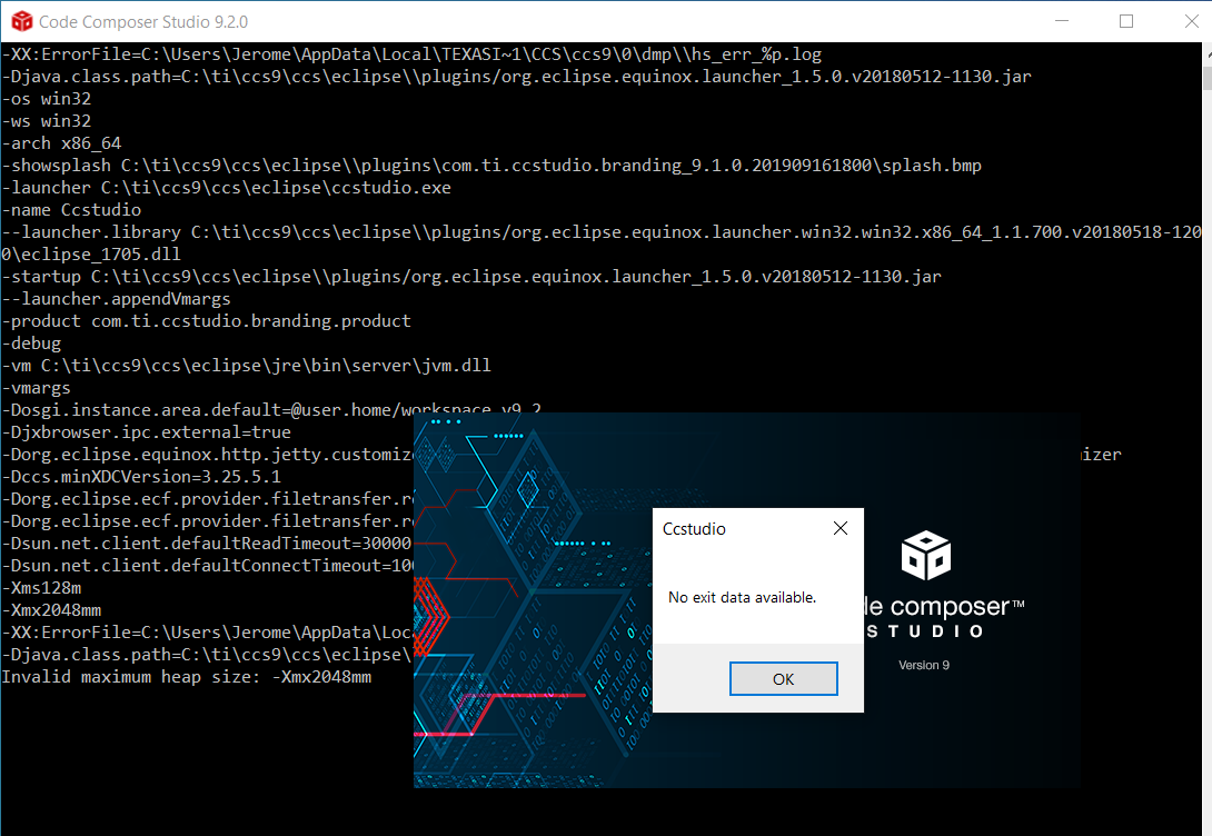

  • Hi Ki,
    I have tried a few values up to 1900m, it build successfully but unfortunately made no difference in the timing, it was always the exact same build time (3mn25s for that reference project on CCS9).
    Edit: I had a typo in my original trial "2048mm", retested with same result for "2048m".
    Thanks for your help,
    Jerome
