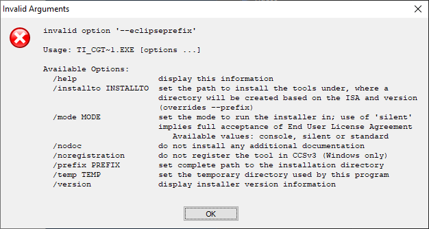

    By the way: During our investigation we found a bug in CCStudio 9.2.0.
    The CGT6.1.23 cannot be installed anymore. Please see the error dialog after trying to do so. Do you have a workaround to install install them anyways? Can you file a bug please?

    Regarding the C6000 CGT installer, I will see if anything can be done from the CCS side, but from a pure compiler installer standpoint there'll not be any work done with respect to this - this compiler is almost seven years old.
    At this point, you should have the installer located at the downloads directory of CCS.
    C:\ti\ccs\eclipse\downloads
    You can run it independently and install it under the tools directory of CCS
    C:\ti\ccs\tools\compiler\ti-cgt-c6000_6.1.23

  • Flux,
    A friend pointed out that an outstanding bug in CCSv9.2 prevents compiler updates from being properly installed.
    I had reported this a while back but the manifestation of the error was different, thus I did not make the correlation.
    I tested in a pre-release version of CCSv9.3 and the compiler installs normally.
