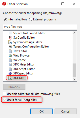

1.  How do I configure CCS so that when I double click on a .cfg file in the project explorer pane, that file is always opened using the XDCONF GUI (rather than opened as a text script file).  It seems hit and miss.  Sometimes I get GUI, sometimes the text editor.  I can manually force use of the GUI by right clicking on the .cfg file, selecting "Open With" then XDCONF, but I'd rather always get the GUI.
    When right-clicking on the .cfg file and selecting "Open With", try select "Other" instead. Then specify that you always wish to use XGCONF for opening .cfg files:

  • Thank you for the quick feedback!  That is very helpful!
