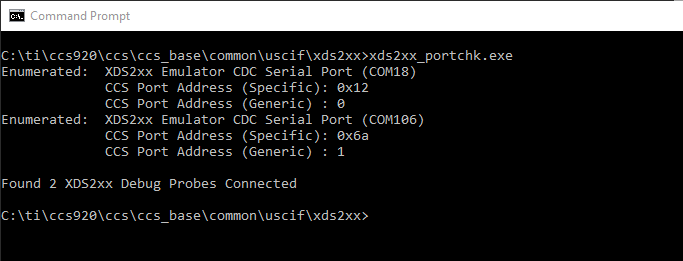

    I believe I can reproduce the issue. In the same directory as xds2xxx_conf.exe, can you run:
    > xds2xxx_portchk.exe
    The output should looks something like:
    Next, when running the xds2xx_conf.exe utility, try passing in the specific port address instead of the generic one. For example, in my environment I would do something like the below for the second XDS200 probe.
    > xds2xxx_conf.exe get xds2xxu 0x6a
    This works for me while the below does NOT:
    > xds2xxx_conf.exe get xds2xxu 1
    It looks like there are issues using the generic address in recent versions of the tools (CCS & UniFlash). In your ccxml file, replace the generic port address with the specific one. See if that works. It appears to have resolved the issue for me.
