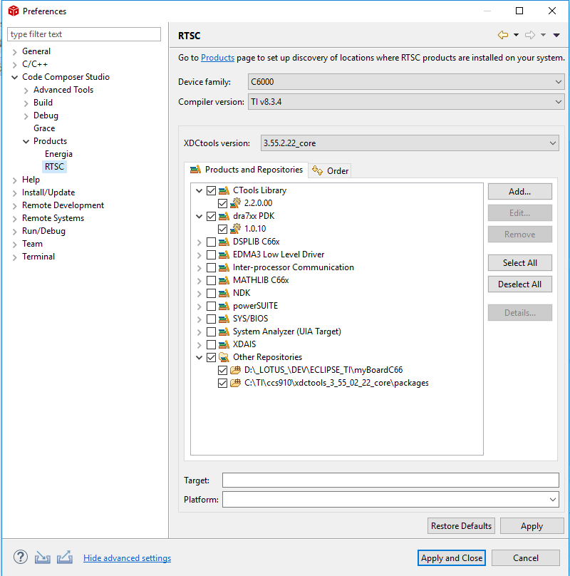

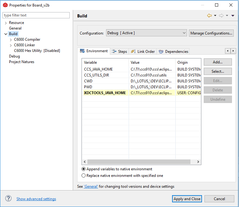

Hi
I have created a CCS test project, but I can not see XDCtools under Build from the project properties. WHY ?
The following are the relevant screen shots
    Is it a RTSC project, (ie) is there a RTSC configuration file (.cfg) in the project? That is what identifies it as a project that requires XDCtools properties.
