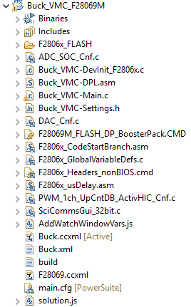

  • AartiG said:
    ControlSuite projects also worked the same way in that most files were linked to the project. Which example from ControlSuite are you referring to that made copies of the source files into your project directory?
    You're right.  Most of my projects have a few local files, .c, .h, .asm files, and a bunch of links.
