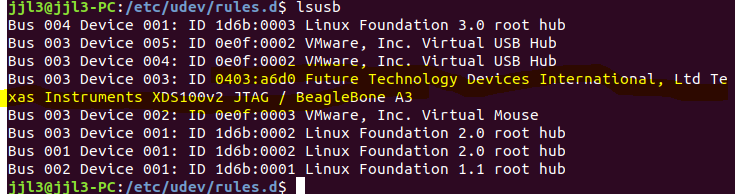

I am learning the ICE_AM335x developing board.
I want to download image to ICE_AM335x board on the linux OS,
but the debugging tools always can not connect to this board.
my OS: win7 + VMware 15.5 + ubuntu 18.04 + CCS9.2
ICE_AM335x: Ver1.0B.
the error as below:

On the windows OS(win7 + CCS9.2) there is not problem, some information as below:

    If I understood everything correctly, you are trying to use your AM3358 ICE board directly from a VmWare running Ubuntu 18.04 as a guest OS, right? If so, the XDS100v2 debug probe does not work well on this scenario, since it operates at a unusable speed. This is reported in the VMWare with CCS page at:
    https://processors.wiki.ti.com/index.php/VMware_with_CCS
    In this case, your options are:
    - have a soldered JTAG connector and purchase an external Debug Probe that is faster with VmWare, such as the TMDSEMU110-U or the TMDSEMU200-U.
    - use your board on a native Windows install
    - get a different host with Linux installed natively
    The two last scenarios allow operating the Debug Probes at the top of performance, therefore preferrable.
    Hope this helps,
    Rafael
  • thanks for your reply!
    there is onboard XDS100V2 based on the chip FT2232 on ICE AM335x developing board,
    according to the information, it seems that the driver of this chip of FT2232 is not correct on Linux,
    but I can not find the instruments about how to install the related driver on Linux.
    Please apologize for the delay; were you able to apply one of the suggestions I sent before? The use of the XDS100v2 will not be feasible with the VmWare.
    Rafael
