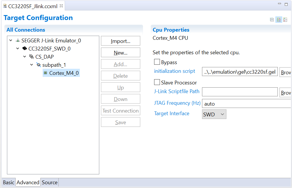

    Regarding the third error, the SOP jumper mode (Flash/Func) requires the Debug Probe to be configured to use four wire JTAG.
    Specifically for the first error with the Jlink, choose the CC3220_SWD device (as mentioned in the other thread) and set the protocol as the following:
    That said, I would keep the tests with the XDS110 built into the Launchpad until you get a more stable code loading process.

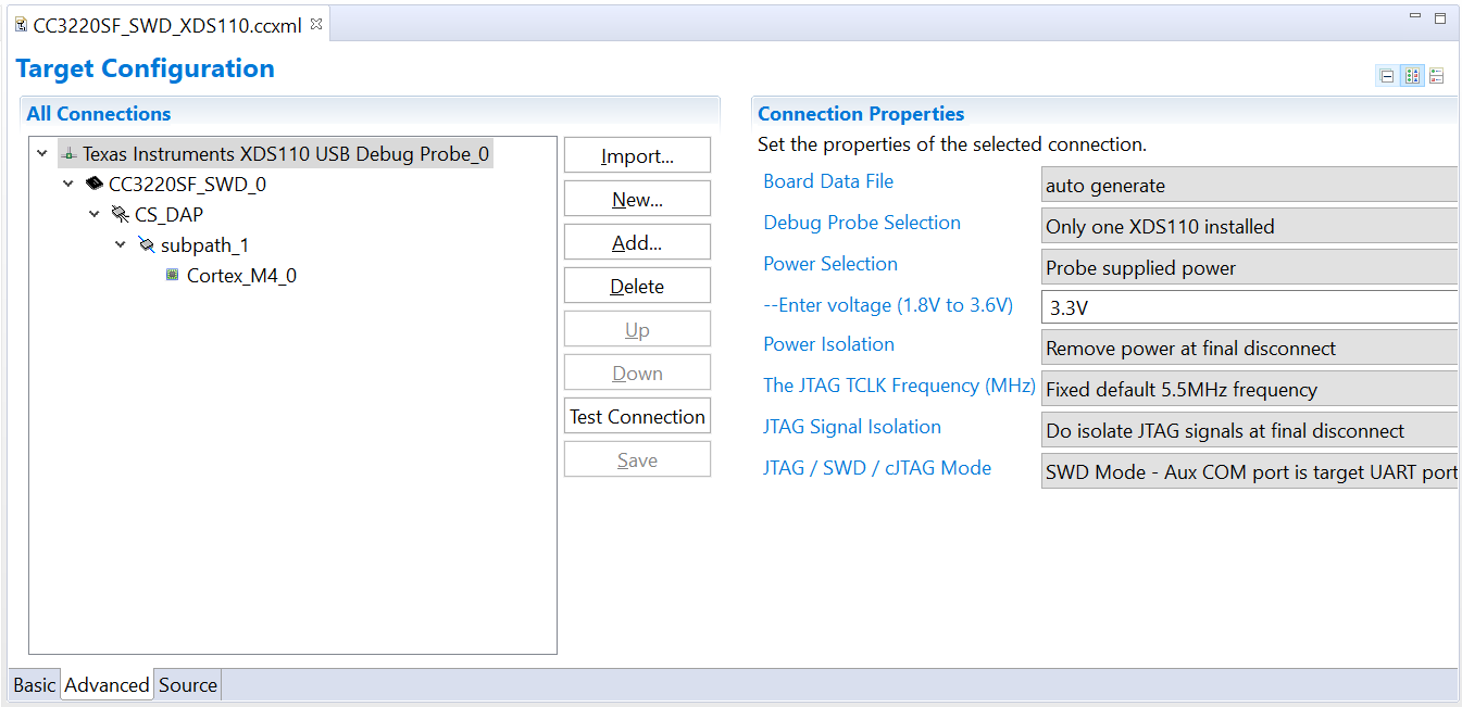

  • I don't have those settings for Target Configuration. Is that a new change? We haven't updated for a couple months. Here's what I have:
    Katie
  • Katie,
    That is just for the Segger Jlink. The XDS Debug Probes are configured directly on the Debug Probe branch.
