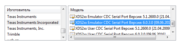

I can manually choose this variant:
And as the result I have the only one device:

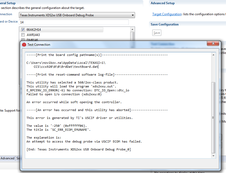

If I start the "Test Connection" in Target configuratio menu, it returns this error after 1 minute process:
If I delete drvers for devoce and let it stay unknown "Test Connection" returns the same error but without 1 minute "thinking".

Also I've tried to do it in Ubuntu 18.04 using the VMWare virtual machine. The result is the same.
I use CCS 9.

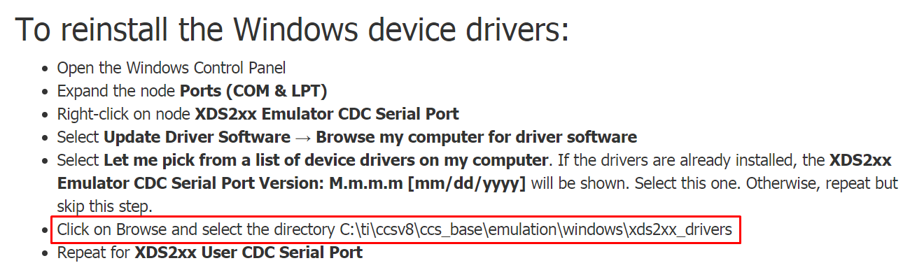

    Also, the Windows drivers shown in your third screenshot above seem quite outdated - the thread you linked talks about the difference between the names of the control panel drivers. I would then manually reinstall the drivers shipped with your CCSv9.2.0 following the procedure on the Troubleshooting section of the page above.

    If I understand you correctly, you adviced to do this:
    I've done it, but it was failed. Windows said something like this: "There are no drivers in this directory". It couldn't find them.

  • Nikolay,
    Please apologize for the delay; the directory contents match what I have here. In my particular case, they work just fine to install the XDS200 drivers.
    At this point I am really unsure what may be happening in your environment - I have both Windows 7 and Windows 10 here and the drivers install perfectly fine using the method I indicated above.
