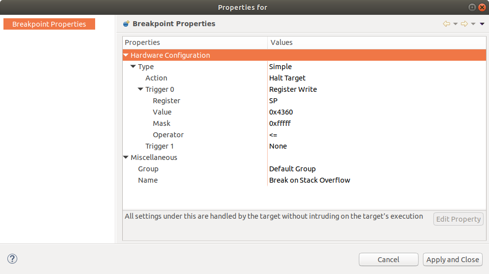

    I found that the workspace in which the crash was originally occurring had a "Break on Stack Overflow" set which was causing CCS to crash when attempting to start a debug session for the MSP430L092. Either of the following prevented a crash when starting a debug session with the MSP430L092 target:
    a. Disable the "Break on Stack Overflow" prior to starting the debug session.
    b. Removing all breakpoints.

    Since a CCS crash was occurring found the following sequence could reliably repeat the failure with CCS 9.3.0 under Ubuntu 18.04.3 LTS:
    1. Create a new CCS workspace, and import the following projects from https://github.com/Chester-Gillon/E2E_example_projects :
    a. MSP430F5528_blinky_filled_flash : For a MSP430F5528 in a MSP-TS430RGC64USB. Used a MSP-FET to debug.
    b. MSP430L092_blinky_duty_cycle : For a MSP430L092 in a MSP-TS430L092. Used a MSP-FET430UIF to debug.
    2. Connect the MSP430F5528, and start a debug session for the MSP430F5528_blinky_filled_flash. When the program has reached main set a "Break on Stack Overflow" with the defaults:
    Which created the following breakpoint:
    The program runs successfully, and doesn't trigger the stack overflow breakpoint.
    3. Terminate the debug session, and then re-start CCS to cause the breakpoint set above to be stored in the workspace settings (since upon a CCS crash the settings don't get stored).
    4. Disconnect the MSP430F5528 target, and connect the MSP430L092 target.
    5. Start a debug session for MSP430L092_blinky_duty_cycle, and CCS crashes before main is reached.
    6. Following the crash, start CCS. Open the Debug perspective and disable the "Break on Stack Overflow" in the Breakpoints view. Start a debug session for MSP430L092_blinky_duty_cycle, and the program reached main.
    Enable the "Break on Stack Overflow" in the Breakpoints view, which causes CCS to crash.

    The issue is that some devices support a trigger type of "Register Write" while others do not. If the debugger tries to apply an existing watchpoint/breakpoint with a trigger type of "Register Write" for a device that does not support it, the debugger crashes.
    I filed a bug for this. Tracking ID is EXT_CCBT-3
