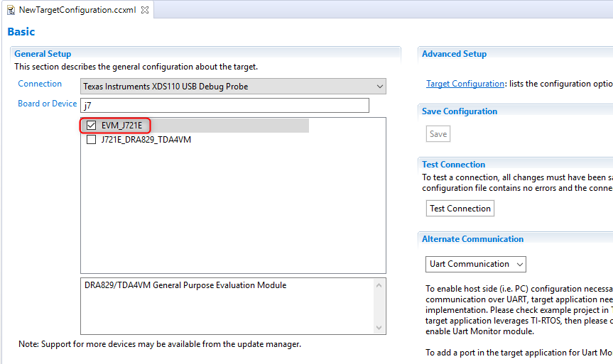

    I am using Updated package : CCS 9.3.0.00012 version.
    Also i am using development board J721EXCP01EVM for J721 series MCU.
    in Code composer studio this development board is not listed so not getting any information the same.
    I need help setting up CCs for J721 and able to compile/debug sample code on development kit : J721EXCP01EVM

  • Vinod,
    vinod bargaje said:
    2. Main objective is to use Eval board for debugging and programming J721E part on J721EXCP01EVM board with CCS.
    3. latest version of CCS (9.3.00012) dose not support for J721EXCP01EVM board as this hardware is not able to detect on my CCS setup.
    CCSv9.3 should support the J721 EVM without the need for any additional emupacks.
    I see it in my stock 9.3 installation:
    ki
