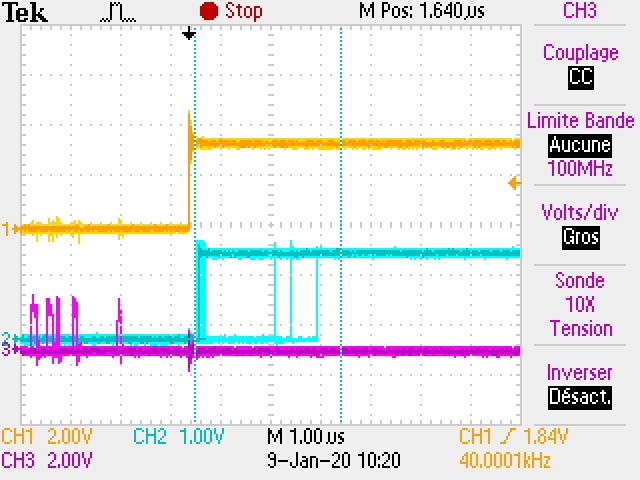

But when I observe the timing on an oscilloscope:
In yellow: the rise is the trig from the C2000 (set of GPIO), and the fall correspond to the end a calculation after the return data from C6000
In blue: the rise is the 1st thing done in the interrupt function, and the fall correspond to the end of calculation in the C6000.
As you can see, the jitter to up to 2.8µs, when you work at 40kHz, 2.8µs is a big deal.

    I'll explain a bit more the oscilloscope screen:
    In yellow, it corresponds to a debug pin used in the C2000, the pin is set in my ADC IT function just before setting the GPIO12, GPIO12 is toggled so it's more complicated to observe this gpio (the gpio IT in the C6000 is set to fire on both edge). But It checked that the gpio was correctly toggled, and it's fine, the toggle appears like 100ns after it is set and it's really stable.
    The fall is not really relevant with the problem, it corresponds to the end of the calculation done in the C2000 after the return of data from the C6000.
    In blue, it correspond to a pin set in the GPIO interrupt function (1st thing done in the function), and the fall correspond to the end of the GPIO interrupt function. This interrupt function is really long but it is the only function that have top priority and shouldn't be stop or delayed. Again the fall of the signal is not relevant with the problem.
    On the previous test there was no gpio set/fall in the timer IT function. I just did the test:
    In blue and yellow: same as previous test
    In purple: debug gpio set when entering timer IT function, cleared when leaving timer IT function
    I observed on the oscilloscope that the shifting of the blue signal occured when the purple signal appears just before the rising of the blue one. the shifting has a duration of about 3.9µs
    I hope this reply will answer your questions.

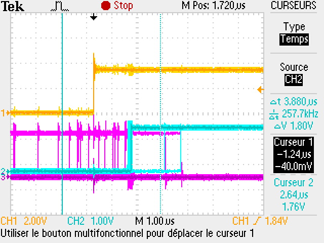

  • Hi Eric,
    1) The debug gpio was used in the gpio function interrupt, so I always had this shifting problem even when the debug gpio is not used in the timer function, the 1st oscilloscope screenshot corresponds to this test. For me it's not a GPIO driving problem. I think it's more because of the interrupt itself.
    Do you know how much time an interrupt function needs to save its context (data, registers...) when an interrupt with a higher priority preempts the current IT function ?
    2) Not sure I really get what you meant, the test is to rise the gpio in the timer IT function and to clear it the gpio it function, right ?
    I did this test, it's not easy to observe because I have to let the oscilloscope on infinite persistence to catch the phenomenon:
    In purple: debug gpio set when entering timer IT function, cleared when entering GPIO IT function
    The GPIO is cleared when entering the function and we can see the shifting.

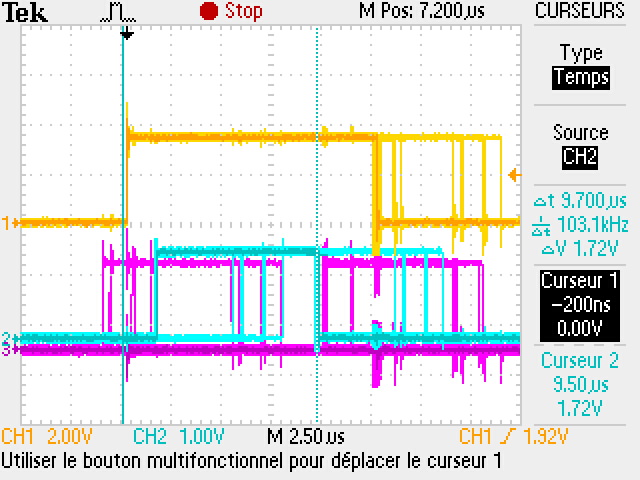

    I thought of another test (maybe it's the one you really wanted), I added some delay in the timer IT function to check if something appears:
    The timer IT fired just before the GPIO IT are not preempted by the GPIO IT, so the gpio function IT is shifted. The purple signals on the right reveals that the timer IT wait for the end of the gpio IT to start (in normal operation, the blue signal falls at the place of the right cursor)
    It feels like the µC waits for the IT function to be over before starting a new IT function, and not priority matters. Is there a register to activate the pre-emption of high priority interrupt ?

    It feels like the µC waits for the IT function to be over before starting a new IT function, and not priority matters. Is there a register to activate the pre-emption of high priority interrupt ? ======> Please see: https://e2e.ti.com/support/processors/f/791/t/226948
    and https://processors.wiki.ti.com/index.php/Configuring_Interrupts_on_Keystone_Devices, searching for "nest".
    You need a OS to do interrupt pre-empt, the SYSBIOS can do this and switching latency needs several hundred CPU cycles.
    Regards, Eric
  • Hi Eric,
    thank you for your answer, I thought the nesting was hardarware on this DSP, my bad.
    I still can't explain why my 100ns timer interrupt function shifts my GPIO IT function this much. But if the nesting resolves the problem, I'll be fine with it.
