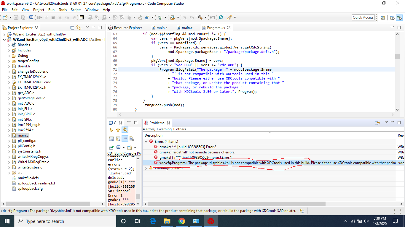

Hey,
I am using CCS Version: 9.2.0.00013. I have  installed xdctools_3_32_00_06_core and TI-RTOS tirtos_tivac_2_16_00_08.
But while building it keep showing error that ti.sysbios.knl  is not compatible with xdc version.
How do I solve that ?
Srinivasan.
  • Hi Srinivasan,
    Can you attach the full build log (please attach and don't copy/paste into the thread)? I expect it is because you are using a newer compiler version. The newer compiler versions have not been validated with TI-RTOS for TivaC. Can you try moving back to the one recommended in the TI-RTOS for TivaC Release Notes?
