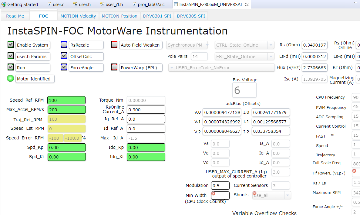

I am trying to spin my 7-12V small motor. (Brushless Motor Roxxy Outrunner C28-24-34)
After identifying the motor parameters , and updating user_j1.h , and then Setting the variable “gMotorVars.Flag_Run_Identify” equal to 1 again , the motor is not spinning. What could be the problem ?

  • 4. I am also having this sign next to the lab2a, and these advices, see picture below
Please have a look at the motor parameters, I am not sure if I shall change something
I Ran Run the Optimizer Assistant to generate data for code size versus --opt_for_speed setting, but this warning still appears.
Here is a screenshot of the gui too.
The voltage seems to be 6V although the battery is 9V, I got a new battery however the motor didnt spin as well.

  • Just use lab02a/lab02b/lab02c to identify the motor parameters, and then use the subsequent lab (lab05b or lab10a) to spin the motor with the updated user.h. The instaSPIN lab guide has a detailed description of operation steps.
    You might have a look at the LaunchPad user's guide as the following link to understand the switches configuration on the board.  The setting mode you mentioned enables the onboard emulator if you need to run/debug the code using CCS or GUI.
