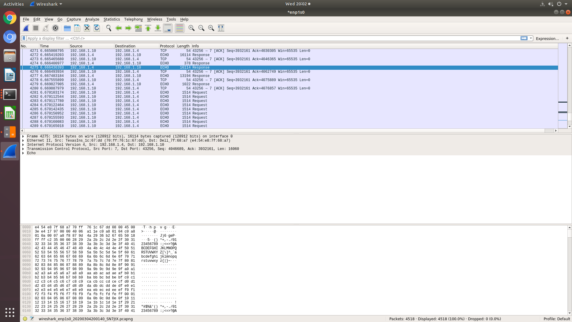

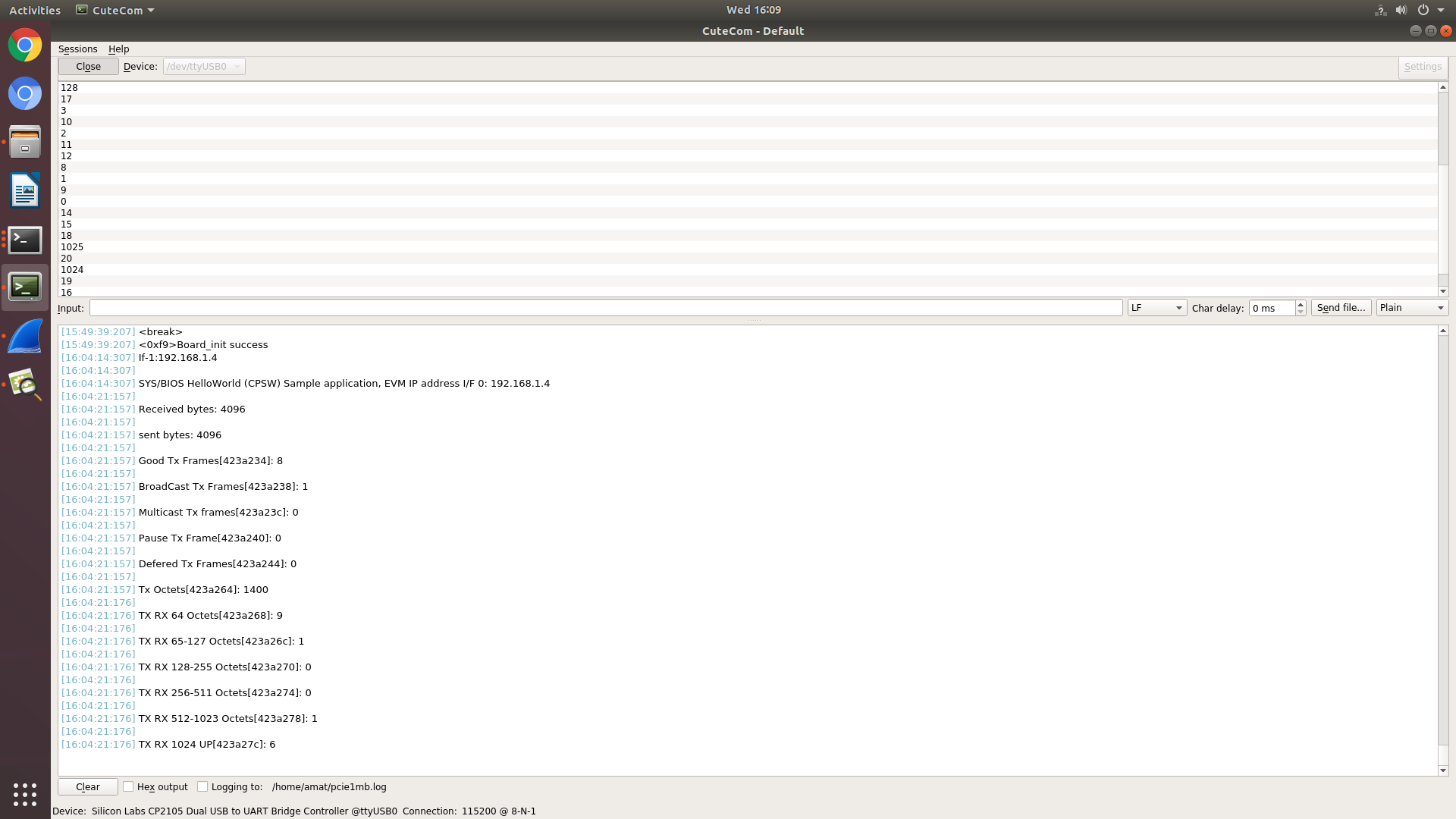

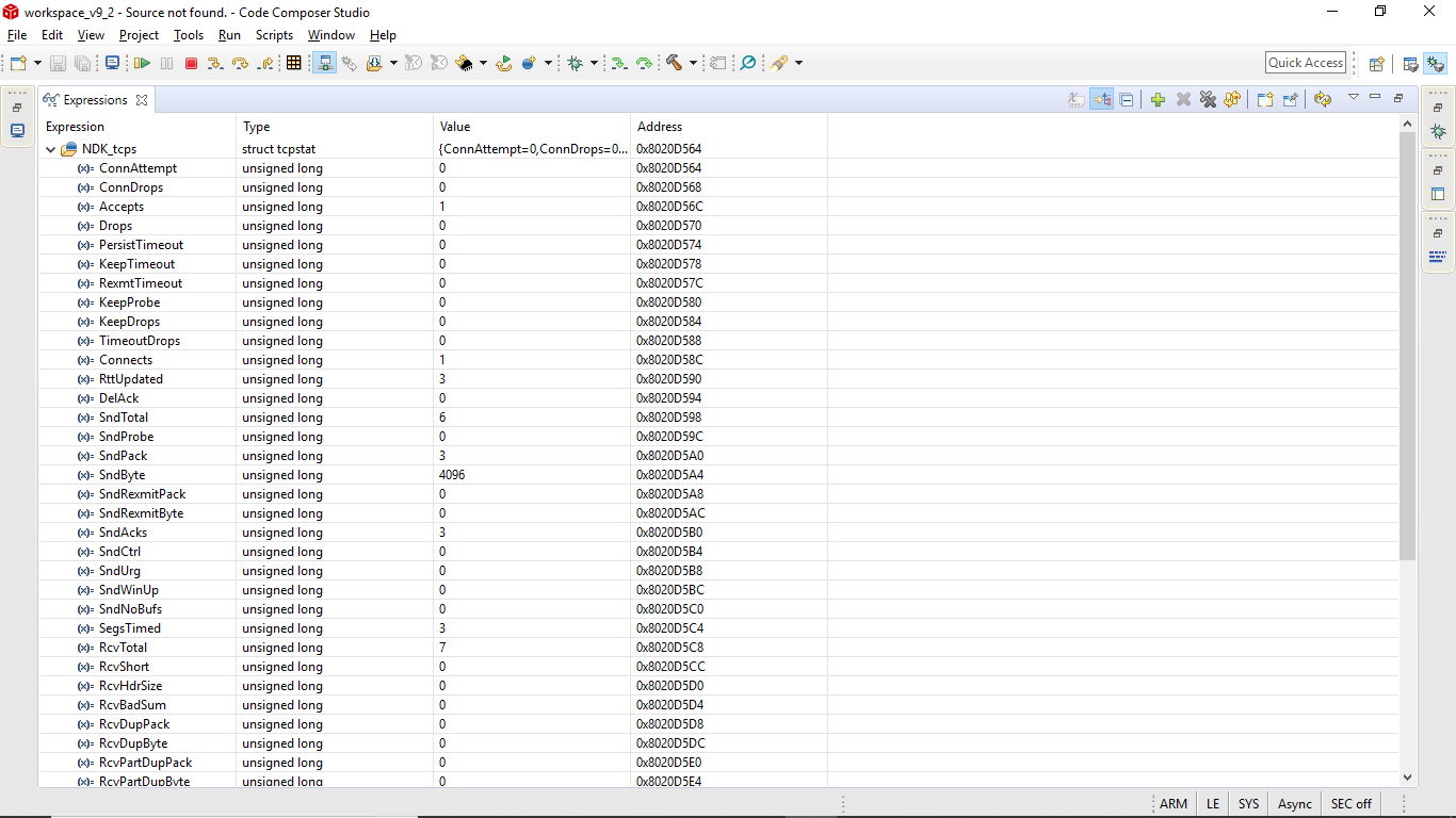

I am using TCP/IP socket programming server/client for transferring data from a EVMK2G board to EVMK2G board. I can able to send/recv 1024 bytes of data at a time when two boards are connected. when I tried to send more than 1024 packets it is not working may I know what will be the reason and what procedure is needed to send 6500 and above bytes of data.
Tcp.transmitBufSize = 16384;
Tcp.receiveBufSize = 65536;
Tcp.receiveBufLimit = 65536;
Global.pktNumFrameBufs=384;
Tcp.maxNumReasmPkts = 2;
the above size of configured in the .cfg file.

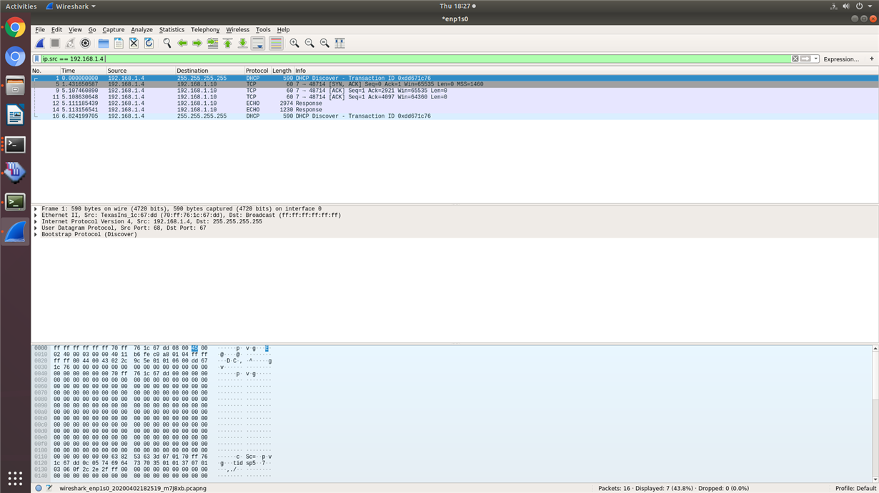

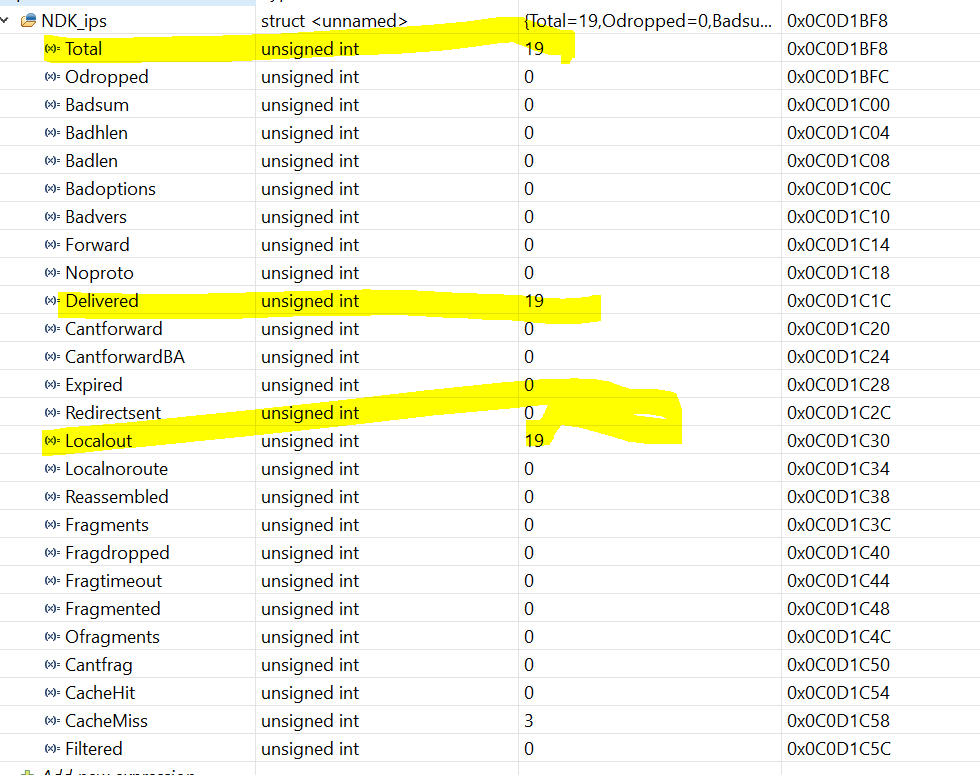

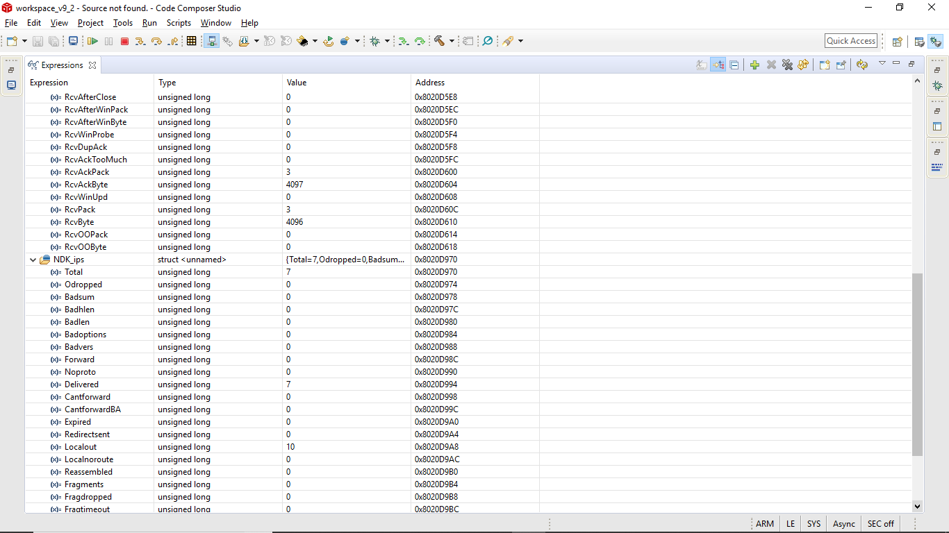

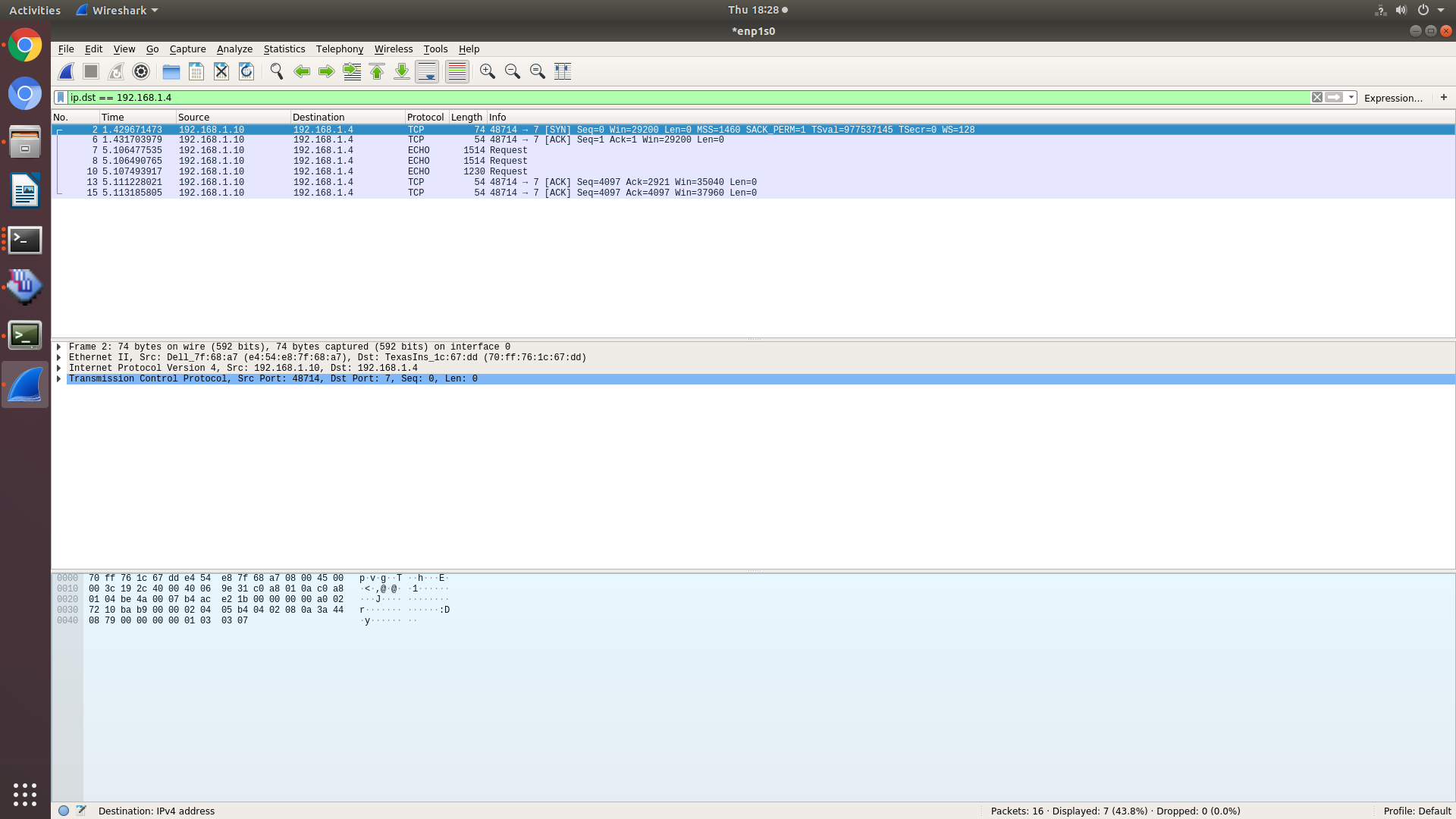

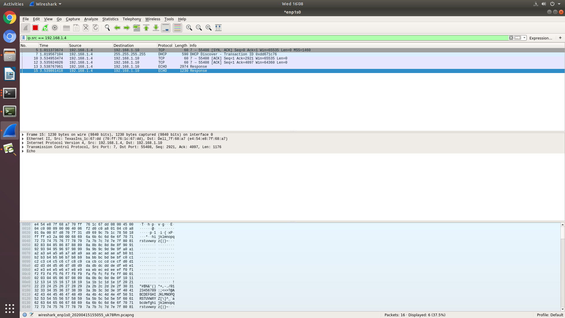

    Actually we coudn't find TI NIMU example code for TCP, but there was a FTP example NIMU_FtpExample_evmK2G_armExampleproject. By refereing this project we wrote TCP server and client.
    When we send 1350 bytes of a packet from the client, it received properly as a single packet in server and we could able to send more packets continuosly from client and the same is received in server without any issue.
    But when we send 1355 bytes of data from client, it gets splitted and received as two packets in server and further no packets are received in server when we try to send more packets from client.
    We even tried K2G EVM with a linux machine and K2G EVM as server and linux machine as client. Here also we observed same behaviour i.e there is no issue with packet size less than 1350 but we are facing issue when we send packet size of 1355.
    Please help us to solve this issue ASAP.

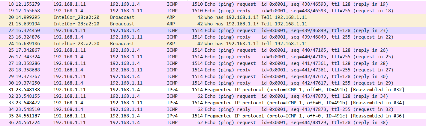

  • Hi Eric,
    Ping works fine for packet size greater than 1514 , when the mtu in linux configured as 1500.
    But it fails, when the mtu size configured as greater than 1500 bytes.
    Thanks for the testing of ping.
    >>> Ping works fine for packet size greater than 1514 , when the mtu in linux configured as 1500. But it fails, when the mtu size configured as greater than 1500 bytes.>>>>
    This is expected. The K2G doesn't supports jumbo packets, it needs to be explicitly enabled in NDK driver and NIMU driver. By default, this is disabled. If Linux changes the MTU size greater than 1500, K2G has no way to receive jumbo packet from Linux machine and no way to reply back.

    We sent 4196 bytes of single frame from linux(192.168.1.10) to K2G(192.168.1.4) and then K2G(192.168.1.4) to linux(192.168.1.10).
    Analysis for K2G to linux side:
    In wireshark total packets captures are 7(2 DHCP, 5 TCP) , in which one packet captured with size greater than 1514 bytes.
    But when i saw in NDK_tcps the SndTotal value is 6 and in NDK_ips both of the Total and Delivered value is 7.
    So the NDK_ips values matches with wireshark captured values. With this can we confirm K2G is sending jumbo packets?
    Attached captured screenshots for reference.
    Thanks for collecting this! I think it means the NDK sent out 7 packets on IP layer and Wireshark also recorded 7 packets, and one of them is a jumbo packet of 2974 bytes. I will check with NDK team and update here.
    Regards, Eric
    From NDK:
    NDK_ips.Total was 7, but that is the receive count (horrible name!!). NDK_ips.Delivered were number of packets delivered to the stack. So 7 makes sense. NDK_ips.Localout was 10. This is the number of IP packets sent. So it looks like the hardware or WireShark is combining.
    From NIMU and EMAC:
    NIMU and EMAC driver does not combine multilple smaller packets into larger one.
    So, the K2G sent out 10, the Wireshark showed 7. It is possible Wireshark is combining?

  • Hi Eric,
    Again i transmitted 4096 bytes of frame , in wireshark i observed 6 packets but the total tx packet count shows as 8 in K2G. I have also printed count for packet size greater than 1024 which is 6(Tx +Rx) but the total RX and Tx packets greater than 1024, captured in wireshark is 5.
    Attached the captured screnshots
    Does this mean Wireshark combined the packets into jumbo, as the K2G CPSW stat showed more packets than the Wireshark saw? If you send a little bit more data, say 16K or 32K bytes, the difference will be much more? Also, there are total bytes sent counter in CPSW stat to understand the bytes sent out, it should be correct. And with total bytes and number of packets transmitted, you can confirm the average packet size, there are no jumbo from K2G?
