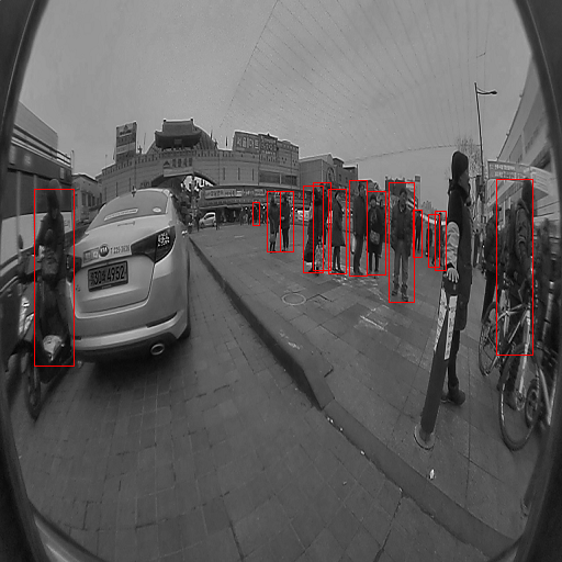

I am using "tidl_j7_01_00_00_00" version for Importing and running the caffe based mobilenet model.
Confidence Threshold used is: 0.08
Keep top_k used is:20
The result observed from PC Emulation output is having some random bounding boxes which can be observed as below:
I am also sharing the import config and inference config file for your reference below:

Please let me know if there is any issue in import/inference config file.
Kindly provide some suggestions too.
