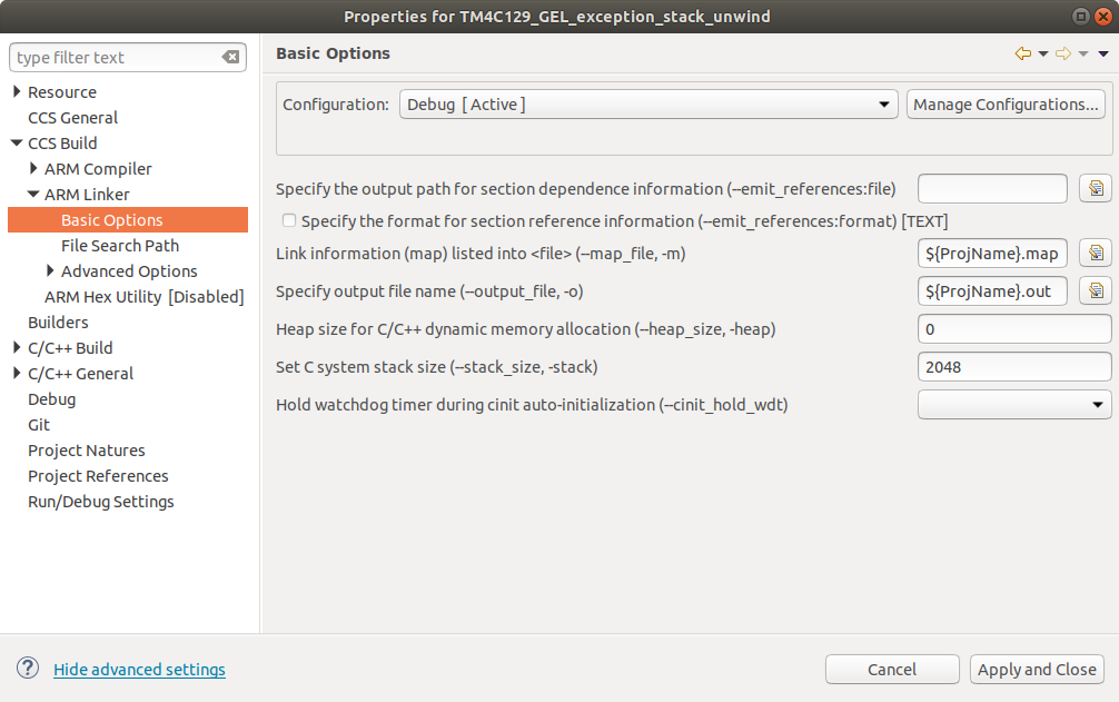

    When creating a project in CCS using the TI ARM compiler for a TM4C device the default is that the "Heap size for C/C++ dynamic memory allocation (--heap_size,-heap)" is set to zero:
    To allow malloc to work the heap size in project properties must be set to a non-zero value which is sufficient for the allocations made by the project.

  • Hi
    I changed the heap size but now i received this error which prevents me from testing the above solution and i can't figure it out
