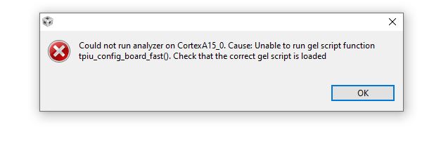

Hi Rafael,
I tried to enable trace in my project as per you mentioned in your reply.But it shows an error message like these.
I have that gel file (AM571x_tpiu.gel that was commented in your gel file) and i loaded it initially.Is it necessary to run those function prior to enabling trace ?? How i run that gel script function tpiu_config_board_fast()??
I had a vague recollection of seeing this error and found the post below.
https://e2e.ti.com/support/tools/ccs/f/81/p/618902/2280714#2280714
If your configuration is set for the "pure" device and not a board, please follow the directions above to properly configure the device.
Hope this helps,
Rafael
The Code Coverage is possible but, if you do not have a board with the full MIPI-60 connector and a XDS ProTrace, the limited size Embedded Trace Buffer (ETB) will present a very narrow snapshot of the various function transitions of the system. This will present itself as a coverage full of gaps during the times the buffer is being offloaded to the host.
