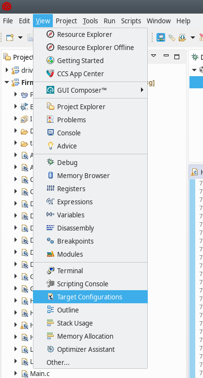

    One important note: At least in CCS version 9.3.0.00012, it is not called "Target Connections" in the view menu. It is called "Target Configurations."

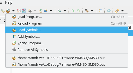

    And "Load symbols file" (down arrow next to button with the curly braces):
