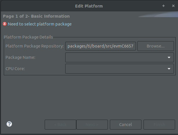

    Instead of using RTSC Tools->New, could you try ->Edit/View Platform? and see if that's what you want?
    Rex
  • "Need to select platform package"
    Maybe I am missing something
    I tried the following paths "~/ti/pdk_c665x_2_0_14/packages/ti/board/src/evmC6657"
     "~/ti/pdk_c665x_2_0_14/packages/ti/board"

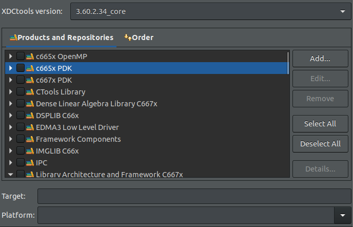

  • I am sure it prompted me about the new products discovery.
    I tried anyways to follow your steps and I can see the in the Products and Repositories section the products related to it.
    Since this is a new machine, I am going to try a fresh install and follow the same steps.
