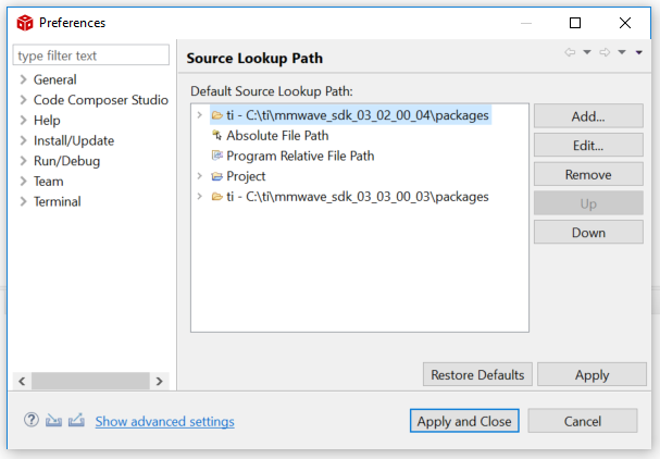

I am trying to debug the file mmwave_link.c which I have opened using the Modules tab to choose from the loaded files. Optimisation level is set to 0 as well. When I now try to set a breakpoint it can be enabled and the debug view tells me the according line but no breakpoint is shown. When I start the sensor it doesn't stop there either.

    In the screenshot of the source file, line 1193 has a comment on it. This leads me to believe that the source file opened in the editor is not the same as the one used to build the executable. How did you set the breakpoint? Did you double click in the editor margin of that source file? If so, the entry appeared in the breakpoints view but not the editor margin of the source file?

  • The executable itself was build on my PC, but the file I am trying to debug is from the SDK which I just downloaded.
    I have had this error message before and after research in the forum I edited my lookup path. Until now I didn't have problems with that particular error anymore. I added the mmwave.c example, because as you can see on the bottom of the screenshot from the prior post, the mmwave.c file has the same compilation path but I can debug it without any problems. And since both files are in one folder I assumed that when one of the files is found due to the edited lookup path the other would be too.
    Maybe you can avise me a better solution than editing the lookup path.

    I was experimenting with some of the mmwave examples and I have a better understanding of the environment now.
    Both mmwave.c and mmwave_link.c are part of one of the libraries that are included in the project. Hence those source files are not compiled on your local machine.

    Do you have multiple versions of the sdk? It looks like the mmwave_link.c file in your debug source search path is not the one used by the library.... like you are pointing to the wrong version than the one used to compile the library.
  • I do have two versions of the sdk on my PC and this is how my lookup path looks like. As there is an up and down option I assume that the order of the paths might be important. Maybe you can give me some more input on that.
    Still I wonder how it is possible that one of the files (mmwave.c) is located correctly and apparently the other (mmwave_link.c) isn't as they are located in the same folder and the lab should be using files from the same sdk version.

  • Can you remove the path for the SDK version that is not being used?
  • I did solve the problem to delete the path to the unused sdk. Thanks a lot!
