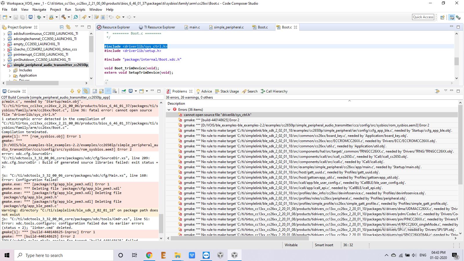

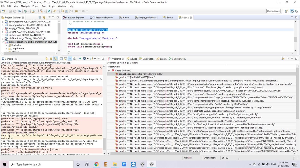

I am working with CC2650 LAUNCHPAD. Is this example code Full Duplex Bidirectional Audio Demo  code will work with CC2650(ble4.2)? If yes then what are the requirements to import this code for CC2650.
  • Thank you Eirik for reply  but when i am importing the code in CCS it show me 26 error all are at "gmake" level any suggestion to remove it?
  • ERRORS in attachment
  • Description Resource Path Location Type
    gmake[1]: *** [rom_sysbios.obj] Error 1 simple_peripheral_audio_transmitter_cc2650lp_app C/C++ Problem
    gmake[1]: *** [build-440148625-inproc] Error 1 simple_peripheral_audio_transmitter_cc2650lp_app C/C++ Problem
    gmake.exe: *** Deleting file `package/cfg/app_ble_pem3.xdl' simple_peripheral_audio_transmitter_cc2650lp_app C/C++ Problem
    gmake.exe: *** [package/cfg/app_ble_pem3.xdl] Error 1 simple_peripheral_audio_transmitter_cc2650lp_app C/C++ Problem
    gmake.exe: *** [package/cfg/app_ble_pem3.xdl] Deleting file `package/cfg/app_ble_pem3.h' simple_peripheral_audio_transmitter_cc2650lp_app C/C++ Problem
    gmake.exe: *** [package/cfg/app_ble_pem3.xdl] Deleting file `package/cfg/app_ble_pem3.c' simple_peripheral_audio_transmitter_cc2650lp_app C/C++ Problem
    gmake: Target 'all' not remade because of errors. simple_peripheral_audio_transmitter_cc2650lp_app C/C++ Problem
    gmake: *** No rule to make target 'C:/ti/tirtos_cc13xx_cc26xx_2_20_01_08/products/tidrivers_cc13xx_cc26xx_2_20_01_10/packages/ti/mw/display/DisplayUART.c', needed by 'Drivers/Display/DisplayUART.obj'. simple_peripheral_audio_transmitter_cc2650lp_app C/C++ Problem
    gmake: *** No rule to make target 'C:/ti/tirtos_cc13xx_cc26xx_2_20_01_08/products/tidrivers_cc13xx_cc26xx_2_20_01_10/packages/ti/mw/display/DisplayDogm1286.c', needed by 'Drivers/Display/DisplayDogm1286.obj'. simple_peripheral_audio_transmitter_cc2650lp_app C/C++ Problem
    gmake: *** No rule to make target 'C:/ti/tirtos_cc13xx_cc26xx_2_20_01_08/products/tidrivers_cc13xx_cc26xx_2_20_01_10/packages/ti/mw/display/Display.c', needed by 'Drivers/Display/Display.obj'. simple_peripheral_audio_transmitter_cc2650lp_app C/C++ Problem
    gmake: *** No rule to make target 'C:/ti/tirtos_cc13xx_cc26xx_2_20_01_08/products/tidrivers_cc13xx_cc26xx_2_20_01_10/packages/ti/drivers/uart/UARTCC26XX.c', needed by 'Drivers/UART/UARTCC26XX.obj'. simple_peripheral_audio_transmitter_cc2650lp_app C/C++ Problem
    gmake: *** No rule to make target 'C:/ti/tirtos_cc13xx_cc26xx_2_20_01_08/products/tidrivers_cc13xx_cc26xx_2_20_01_10/packages/ti/drivers/UART.c', needed by 'Drivers/UART/UART.obj'. simple_peripheral_audio_transmitter_cc2650lp_app C/C++ Problem
    gmake: *** No rule to make target 'C:/ti/tirtos_cc13xx_cc26xx_2_20_01_08/products/tidrivers_cc13xx_cc26xx_2_20_01_10/packages/ti/drivers/spi/SPICC26XXDMA.c', needed by 'Drivers/SPI/SPICC26XXDMA.obj'. simple_peripheral_audio_transmitter_cc2650lp_app C/C++ Problem
    gmake: *** No rule to make target 'C:/ti/tirtos_cc13xx_cc26xx_2_20_01_08/products/tidrivers_cc13xx_cc26xx_2_20_01_10/packages/ti/drivers/SPI.c', needed by 'Drivers/SPI/SPI.obj'. simple_peripheral_audio_transmitter_cc2650lp_app C/C++ Problem
    gmake: *** No rule to make target 'C:/ti/tirtos_cc13xx_cc26xx_2_20_01_08/products/tidrivers_cc13xx_cc26xx_2_20_01_10/packages/ti/drivers/rf/RFCC26XX_singleMode.c', needed by 'Drivers/RF/RFCC26XX_singleMode.obj'. simple_peripheral_audio_transmitter_cc2650lp_app C/C++ Problem
    gmake: *** No rule to make target 'C:/ti/tirtos_cc13xx_cc26xx_2_20_01_08/products/tidrivers_cc13xx_cc26xx_2_20_01_10/packages/ti/drivers/pin/PINCC26XX.c', needed by 'Drivers/PIN/PINCC26XX.obj'. simple_peripheral_audio_transmitter_cc2650lp_app C/C++ Problem
    gmake: *** No rule to make target 'C:/ti/tirtos_cc13xx_cc26xx_2_20_01_08/products/tidrivers_cc13xx_cc26xx_2_20_01_10/packages/ti/drivers/pdm/Codec1.c', needed by 'Drivers/Codec1/Codec1.obj'. simple_peripheral_audio_transmitter_cc2650lp_app C/C++ Problem
    gmake: *** No rule to make target 'C:/ti/tirtos_cc13xx_cc26xx_2_20_01_08/products/tidrivers_cc13xx_cc26xx_2_20_01_10/packages/ti/drivers/dma/UDMACC26XX.c', needed by 'Drivers/UDMA/UDMACC26XX.obj'. simple_peripheral_audio_transmitter_cc2650lp_app C/C++ Problem
    gmake: *** No rule to make target 'C:/ti/simplelink/ble_sdk_2_02_01_18/src/profiles/simple_profile/cc26xx/simple_gatt_profile.c', needed by 'Profiles/simple_gatt_profile.obj'. simple_peripheral_audio_transmitter_cc2650lp_app C/C++ Problem
    gmake: *** No rule to make target 'C:/ti/simplelink/ble_sdk_2_02_01_18/src/profiles/roles/cc26xx/peripheral.c', needed by 'Profiles/peripheral.obj'. simple_peripheral_audio_transmitter_cc2650lp_app C/C++ Problem
    gmake: *** No rule to make target 'C:/ti/simplelink/ble_sdk_2_02_01_18/src/profiles/dev_info/cc26xx/devinfoservice.c', needed by 'Profiles/devinfoservice.obj'. simple_peripheral_audio_transmitter_cc2650lp_app C/C++ Problem
    gmake: *** No rule to make target 'C:/ti/simplelink/ble_sdk_2_02_01_18/src/icall/app/icall_api.c', needed by 'ICallBLE/icall_api.obj'. simple_peripheral_audio_transmitter_cc2650lp_app C/C++ Problem
    gmake: *** No rule to make target 'C:/ti/simplelink/ble_sdk_2_02_01_18/src/icall/app/ble_user_config.c', needed by 'ICallBLE/ble_user_config.obj'. simple_peripheral_audio_transmitter_cc2650lp_app C/C++ Problem
    gmake: *** No rule to make target 'C:/ti/simplelink/ble_sdk_2_02_01_18/src/host/gattservapp_util.c', needed by 'Profiles/gattservapp_util.obj'. simple_peripheral_audio_transmitter_cc2650lp_app C/C++ Problem
    gmake: *** No rule to make target 'C:/ti/simplelink/ble_sdk_2_02_01_18/src/host/gatt_uuid.c', needed by 'Profiles/gatt_uuid.obj'. simple_peripheral_audio_transmitter_cc2650lp_app C/C++ Problem
    gmake: *** No rule to make target 'C:/ti/simplelink/ble_sdk_2_02_01_18/src/examples/simple_peripheral/cc26xx/app/main.c', needed by 'Startup/main.obj'. simple_peripheral_audio_transmitter_cc2650lp_app C/C++ Problem
    gmake: *** No rule to make target 'C:/ti/simplelink/ble_sdk_2_02_01_18/src/components/icall/src/icall.c', needed by 'ICall/icall.obj'. simple_peripheral_audio_transmitter_cc2650lp_app C/C++ Problem
    gmake: *** No rule to make target 'C:/ti/simplelink/ble_sdk_2_02_01_18/src/components/icall/src/icall_cc2650.c', needed by 'ICall/icall_cc2650.obj'. simple_peripheral_audio_transmitter_cc2650lp_app C/C++ Problem
    gmake: *** No rule to make target 'C:/ti/simplelink/ble_sdk_2_02_01_18/src/components/hal/src/target/_common/TRNGCC26XX.c', needed by 'Drivers/TRNG/TRNGCC26XX.obj'. simple_peripheral_audio_transmitter_cc2650lp_app C/C++ Problem
    gmake: *** No rule to make target 'C:/ti/simplelink/ble_sdk_2_02_01_18/src/common/cc26xx/util.c', needed by 'Application/util.obj'. simple_peripheral_audio_transmitter_cc2650lp_app C/C++ Problem
    gmake: *** No rule to make target 'C:/ti/simplelink/ble_sdk_2_02_01_18/src/common/cc26xx/ecc/ECCROMCC26XX.c', needed by 'Drivers/ECC/ECCROMCC26XX.obj'. simple_peripheral_audio_transmitter_cc2650lp_app C/C++ Problem
    gmake: *** No rule to make target 'C:/ti/simplelink/ble_sdk_2_02_01_18/src/common/cc26xx/board_key.c', needed by 'Application/board_key.obj'. simple_peripheral_audio_transmitter_cc2650lp_app C/C++ Problem
    gmake: *** No rule to make target 'C:/ti/simplelink/ble_sdk_2_02_01_18/examples/cc2650lp/simple_peripheral/iar/config/ccfg_app_ble.c', needed by 'Startup/ccfg_app_ble.obj'. simple_peripheral_audio_transmitter_cc2650lp_app C/C++ Problem
    gmake: *** [D:/VOIS/ble_examples-ble_examples-2.2/examples/cc2650lp/simple_peripheral_audio_transmitter/ccs/config/src/sysbios/rom_sysbios.aem3] Error 2 simple_peripheral_audio_transmitter_cc2650lp_app C/C++ Problem
    gmake: *** [build-440148625] Error 2 simple_peripheral_audio_transmitter_cc2650lp_app C/C++ Problem
    cannot open source file "driverlib/sys_ctrl.h" .ccsproject /simple_peripheral_audio_transmitter_cc2650lp_app line 36, external location: C:\ti\tirtos_cc13xx_cc26xx_2_21_00_06\products\bios_6_46_01_37\packages\ti\sysbios\family\arm\cc26xx\Boot.c C/C++ Problem

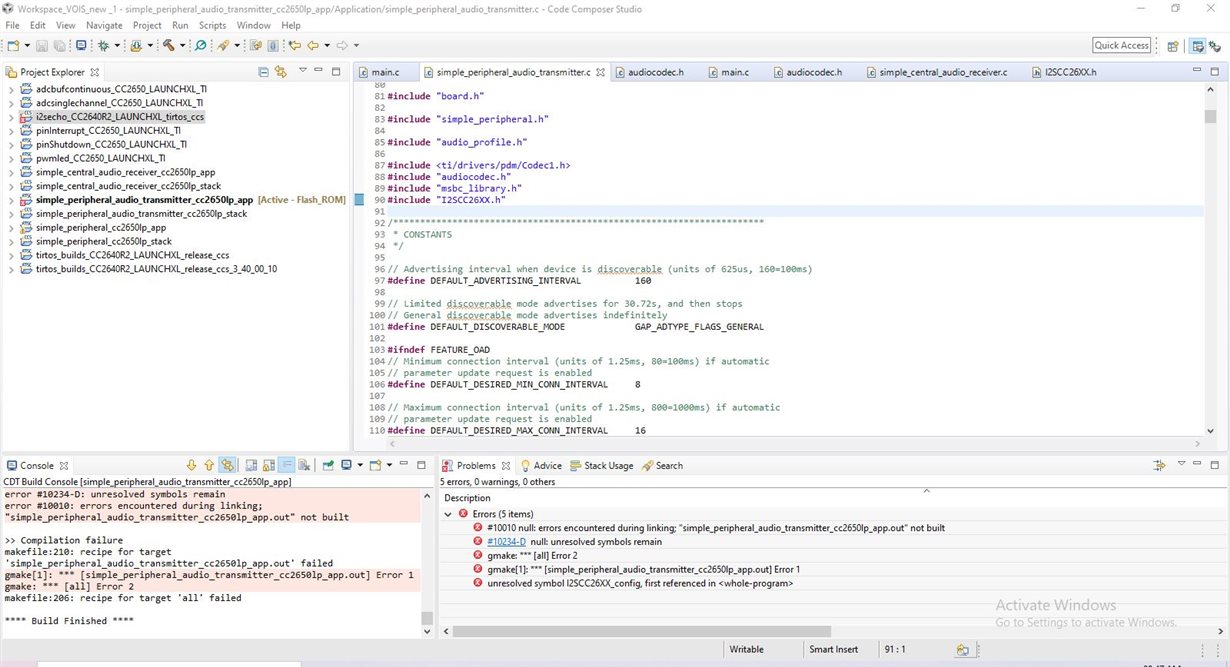

    why such error are coming after addin I2SCC26XX.h file already?error logs are below with pics:-
    **** Build of configuration Flash_ROM for project simple_peripheral_audio_transmitter_cc2650lp_app ****
    "C:\\ti\\ccsv8\\utils\\bin\\gmake" -k -j 4 all -O
    Building file: "C:/ti/simplelink/ble_sdk_2_02_01_18/src/examples/simple_peripheral_audio_transmitter/cc26xx/app/simple_peripheral_audio_transmitter.c"
    Invoking: ARM Compiler
    "C:/ti/ccsv8/tools/compiler/ti-cgt-arm_16.9.11.LTS/bin/armcl" --cmd_file="C:/ti/simplelink/ble_sdk_2_02_01_18/src/config/build_components.opt" --cmd_file="C:/ti/simplelink/ble_sdk_2_02_01_18/examples/cc2650lp/simple_peripheral_audio_transmitter/ccs/app/../../iar/stack/build_config.opt" --cmd_file="C:/ti/simplelink/ble_sdk_2_02_01_18/examples/cc2650lp/simple_peripheral_audio_transmitter/ccs/app/../config/ccs_compiler_defines.bcfg" -mv7M3 --code_state=16 --float_support=vfplib -me -O4 --opt_for_speed=0 --include_path="D:/VOIS/Workspace_VOIS_new _1/simple_peripheral_audio_transmitter_cc2650lp_app" --include_path="C:/ti/simplelink/ble_sdk_2_02_01_18/src/util/audio_codec" --include_path="C:/ti/simplelink/ble_sdk_2_02_01_18/examples/util/mSBClibrary/include" --include_path="C:/ti/simplelink/ble_sdk_2_02_01_18/src/boards/CC2650_LAUNCHXL" --include_path="C:/ti/simplelink/ble_sdk_2_02_01_18/src/profiles/audio" --include_path="C:/ti/simplelink/ble_sdk_2_02_01_18/src/examples/simple_peripheral/cc26xx/app" --include_path="C:/ti/simplelink/ble_sdk_2_02_01_18/src/inc" --include_path="C:/ti/simplelink/ble_sdk_2_02_01_18/src/icall/inc" --include_path="C:/ti/simplelink/ble_sdk_2_02_01_18/src/profiles/audio" --include_path="C:/ti/simplelink/ble_sdk_2_02_01_18/src/profiles/roles/cc26xx" --include_path="C:/ti/simplelink/ble_sdk_2_02_01_18/src/profiles/roles" --include_path="C:/ti/simplelink/ble_sdk_2_02_01_18/src/profiles/dev_info" --include_path="C:/ti/simplelink/ble_sdk_2_02_01_18/src/profiles/simple_profile/cc26xx" --include_path="C:/ti/simplelink/ble_sdk_2_02_01_18/src/profiles/simple_profile" --include_path="C:/ti/simplelink/ble_sdk_2_02_01_18/src/common/cc26xx" --include_path="C:/ti/simplelink/ble_sdk_2_02_01_18/src/components/heapmgr" --include_path="C:/ti/simplelink/ble_sdk_2_02_01_18/src/controller/cc26xx/inc" --include_path="C:/ti/simplelink/ble_sdk_2_02_01_18/src/components/hal/src/target/_common" --include_path="C:/ti/simplelink/ble_sdk_2_02_01_18/src/target" --include_path="C:/ti/simplelink/ble_sdk_2_02_01_18/src/components/hal/src/target/_common/cc26xx" --include_path="C:/ti/simplelink/ble_sdk_2_02_01_18/src/components/hal/src/inc" --include_path="C:/ti/simplelink/ble_sdk_2_02_01_18/src/components/osal/src/inc" --include_path="C:/ti/simplelink/ble_sdk_2_02_01_18/src/components/services/src/sdata" --include_path="C:/ti/simplelink/ble_sdk_2_02_01_18/src/components/services/src/saddr" --include_path="C:/ti/simplelink/ble_sdk_2_02_01_18/src/components/icall/src/inc" --include_path="C:/ti/simplelink/ble_sdk_2_02_01_18/src/inc" --include_path="C:/ti/tirtos_cc13xx_cc26xx_2_20_01_08/products/cc26xxware_2_24_02_17393" --include_path="C:/ti/ccsv8/tools/compiler/ti-cgt-arm_16.9.11.LTS/include" --define=xDLE_ENABLED --define=USE_ICALL --define=POWER_SAVING --define=MAX_NUM_PDU=6 --define=MAX_PDU_SIZE=107 --define=SBP_TASK_STACK_SIZE=900 --define=GAPROLE_TASK_STACK_SIZE=700 --define=HEAPMGR_SIZE=0 --define=xDisplay_DISABLE_ALL --define=xBOARD_DISPLAY_EXCLUDE_UART --define=BOARD_DISPLAY_EXCLUDE_LCD --define=AUDIO_TRANSMITTER --define=ICALL_MAX_NUM_TASKS=3 --define=ICALL_MAX_NUM_ENTITIES=6 --define=xdc_runtime_Assert_DISABLE_ALL --define=xdc_runtime_Log_DISABLE_ALL --define=MAX_NUM_BLE_CONNS=1 --define=CC2650_LAUNCHXL --define=CC26XX --c99 --relaxed_ansi --plain_char=unsigned --diag_suppress=48 --diag_warning=225 --diag_wrap=off --display_error_number --gen_func_subsections=on --embedded_constants=on --unaligned_access=on --enum_type=packed --wchar_t=16 --abi=eabi --common=on --fp_reassoc=off --sat_reassoc=off --preproc_with_compile --preproc_dependency="Application/simple_peripheral_audio_transmitter.d_raw" --obj_directory="Application" --cmd_file="configPkg/compiler.opt" "C:/ti/simplelink/ble_sdk_2_02_01_18/src/examples/simple_peripheral_audio_transmitter/cc26xx/app/simple_peripheral_audio_transmitter.c"
    Finished building: "C:/ti/simplelink/ble_sdk_2_02_01_18/src/examples/simple_peripheral_audio_transmitter/cc26xx/app/simple_peripheral_audio_transmitter.c"
    Building target: "simple_peripheral_audio_transmitter_cc2650lp_app.out"
    Invoking: ARM Linker
    "C:/ti/ccsv8/tools/compiler/ti-cgt-arm_16.9.11.LTS/bin/armcl" --cmd_file="C:/ti/simplelink/ble_sdk_2_02_01_18/src/config/build_components.opt" --cmd_file="C:/ti/simplelink/ble_sdk_2_02_01_18/examples/cc2650lp/simple_peripheral_audio_transmitter/ccs/app/../../iar/stack/build_config.opt" --cmd_file="C:/ti/simplelink/ble_sdk_2_02_01_18/examples/cc2650lp/simple_peripheral_audio_transmitter/ccs/app/../config/ccs_compiler_defines.bcfg" -mv7M3 --code_state=16 --float_support=vfplib -me -O4 --opt_for_speed=0 --define=xDLE_ENABLED --define=USE_ICALL --define=POWER_SAVING --define=MAX_NUM_PDU=6 --define=MAX_PDU_SIZE=107 --define=SBP_TASK_STACK_SIZE=900 --define=GAPROLE_TASK_STACK_SIZE=700 --define=HEAPMGR_SIZE=0 --define=xDisplay_DISABLE_ALL --define=xBOARD_DISPLAY_EXCLUDE_UART --define=BOARD_DISPLAY_EXCLUDE_LCD --define=AUDIO_TRANSMITTER --define=ICALL_MAX_NUM_TASKS=3 --define=ICALL_MAX_NUM_ENTITIES=6 --define=xdc_runtime_Assert_DISABLE_ALL --define=xdc_runtime_Log_DISABLE_ALL --define=MAX_NUM_BLE_CONNS=1 --define=CC2650_LAUNCHXL --define=CC26XX --c99 --relaxed_ansi --plain_char=unsigned --diag_suppress=48 --diag_warning=225 --diag_wrap=off --display_error_number --gen_func_subsections=on --embedded_constants=on --unaligned_access=on --enum_type=packed --wchar_t=16 --abi=eabi --common=on --fp_reassoc=off --sat_reassoc=off -z -m"simple_peripheral_audio_transmitter_cc2650lp_app.map" --heap_size=0 --stack_size=256 -i"C:/ti/ccsv8/tools/compiler/ti-cgt-arm_16.9.11.LTS/lib" -i"C:/ti/ccsv8/tools/compiler/ti-cgt-arm_16.9.11.LTS/include" --reread_libs --diag_suppress=10247-D --diag_suppress=16002-D --diag_wrap=off --display_error_number --warn_sections --xml_link_info="simple_peripheral_audio_transmitter_cc2650lp_app_linkInfo.xml" --rom_model --unused_section_elimination=on -o "simple_peripheral_audio_transmitter_cc2650lp_app.out" "./Application/board_key.obj" "./Application/simple_peripheral_audio_transmitter.obj" "./Application/util.obj" "./Drivers/Audio Codec/audiocodec.obj" "./Drivers/Codec1/Codec1.obj" "./Drivers/Display/Display.obj" "./Drivers/Display/DisplayDogm1286.obj" "./Drivers/Display/DisplayUart.obj" "./Drivers/ECC/ECCROMCC26XX.obj" "./Drivers/I2S/I2SCC26XX.obj" "./Drivers/PIN/PINCC26XX.obj" "./Drivers/RF/RFCC26XX_singleMode.obj" "./Drivers/SPI/SPI.obj" "./Drivers/SPI/SPICC26XXDMA.obj" "./Drivers/TRNG/TRNGCC26XX.obj" "./Drivers/UART/UART.obj" "./Drivers/UART/UARTCC26XX.obj" "./Drivers/UDMA/UDMACC26XX.obj" "./ICall/icall.obj" "./ICall/icall_cc2650.obj" "./ICallBLE/ble_user_config.obj" "./ICallBLE/icall_api.obj" "./Profiles/audio_profile.obj" "./Profiles/devinfoservice.obj" "./Profiles/gatt_uuid.obj" "./Profiles/gattservapp_util.obj" "./Profiles/peripheral.obj" "./Profiles/simple_gatt_profile.obj" "./Startup/CC2650_LAUNCHXL.obj" "./Startup/ccfg_app_ble.obj" "./Startup/main.obj" "C:/ti/simplelink/ble_sdk_2_02_01_18/examples/util/mSBClibrary/bin/cc2650_mSBCencode_library.lib" -l"configPkg/linker.cmd" -l"C:/ti/simplelink/ble_sdk_2_02_01_18/examples/cc2650lp/simple_peripheral_audio_transmitter/ccs/config/ccs_linker_defines.cmd" -l"C:/ti/simplelink/ble_sdk_2_02_01_18/src/common/cc26xx/ccs/cc26xx_app.cmd" -l"C:/ti/tirtos_cc13xx_cc26xx_2_20_01_08/products/cc26xxware_2_24_02_17393/driverlib/bin/ccs/driverlib.lib" -l"C:/ti/simplelink/ble_sdk_2_02_01_18/src/rom/common_rom_releases/03282014/common_rom.symbols" -l"C:/ti/simplelink/ble_sdk_2_02_01_18/examples/util/mSBClibrary/bin/cc2650_mSBCdecode_library.lib" -llibc.a
    <Linking>
    undefined first referenced
    symbol in file
    I2SCC26XX_config <whole-program>
    error #10234-D: unresolved symbols remain
    error #10010: errors encountered during linking; "simple_peripheral_audio_transmitter_cc2650lp_app.out" not built
    >> Compilation failure
    makefile:210: recipe for target 'simple_peripheral_audio_transmitter_cc2650lp_app.out' failed
    gmake[1]: *** [simple_peripheral_audio_transmitter_cc2650lp_app.out] Error 1
    gmake: *** [all] Error 2
    makefile:206: recipe for target 'all' failed
    **** Build Finished ****
  • Hello Eirik Good Morning,
    i am getting such error after at all adding header fiels how I will resolved it?
    Error log are below with snap.
    <Linking>
    symbol in file
    >> Compilation failure
