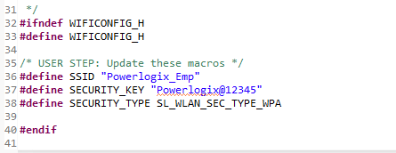

7) configured wifi ssid and key as per my router.

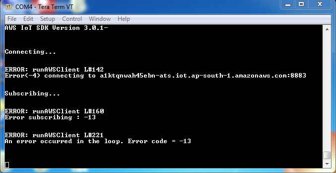

after that i took binary file of the project and i burned the program inside cc3235s . and i got this.....
it recognized all the certificate and keys successfully but its not getting connect with the AWS server or connection is not getting established or TLS handshake failed.
please guide me to resolve this problem.

    and i read some where that subscribe_publish_sample_CC3235S_LAUNCHXL_freertos_ccs program supported only production mode. so i burned the program in production mode also but no luck.
    what's wrong i am doing every time i am getting error(-4) that is
    please let me know where i am wrong and what should i try for it.

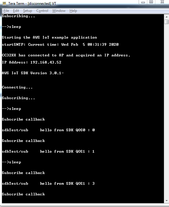

    Please give that a try and see if it resolves your issues. Let me know what happens if you use that root_ca_pem[] file.
    Michael
  • Hi Michael,
    Thank you so much for your valuable reply..
    it's worked well ...

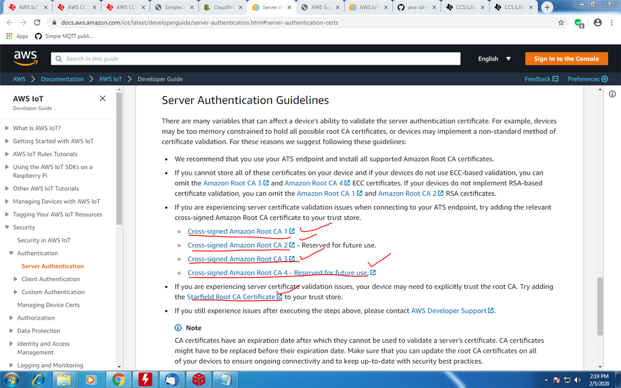

    Que.1: From where should i download this certificate?
    because i have downloaded almost all the certificates those appeared at the time of thing creation. see the this following pictures those tells, which certificates i downloaded..
    but no one is matching with your given certificate. kindly clarify..

  • Hi Sarju,
    I'm glad you got the AWS IoT connection working.
    See my post here for an explanation of why that specific Starfield root CA cert is needed and not any of the one provided by Amazon: https://e2e.ti.com/support/wireless-connectivity/wifi/f/968/p/789112/2919312#2919312
    You can find it online but the method I use simply takes it from your PC's cert store. You can find a post of mine demonstrating how you'd get it from your PC here:
    https://e2e.ti.com/support/wireless-connectivity/wifi/f/968/p/673247/2478357#2478357
    The steps are for a different root CA but you can search for the Starfield cert. You'll need to save it as a Base-64 encoded file though, instead of DER formatted-file.
    That Starfield Class 2 Certification Authority cert is used for all ATS-secured AWS IoT endpoints at the moment.
