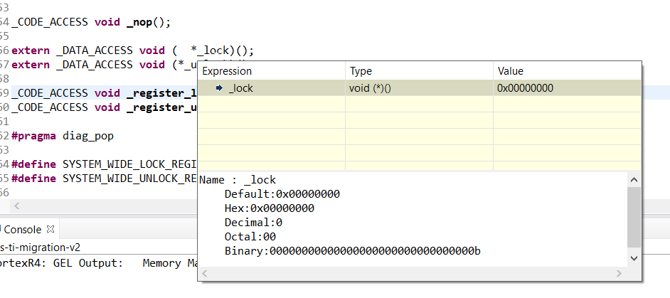

I'm currently facing an issue where my lock() and unlock() functions are not successfully being mapped to _nop(), instead mapping to 0x0. Which options do I need to set in the linker configuration to solve this? Or do I need to rebuild the library?
Many thanks,
Pedro

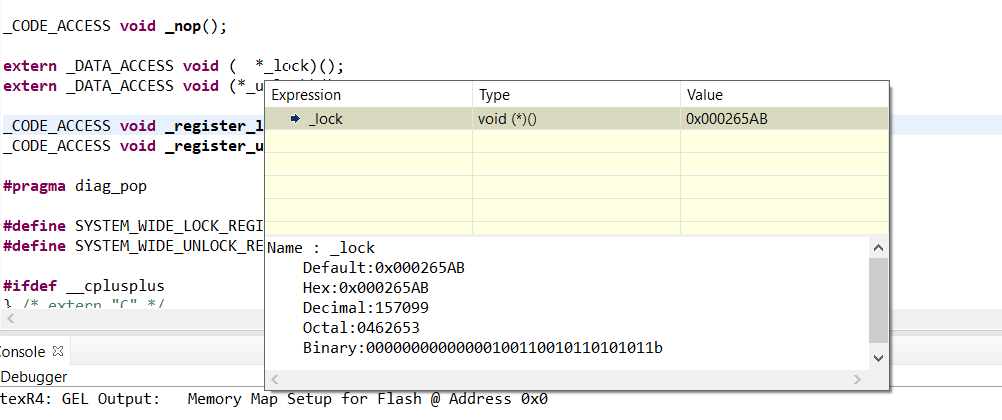

  • This is what a good mapping looks like:
    And this is what my mapping looks like:

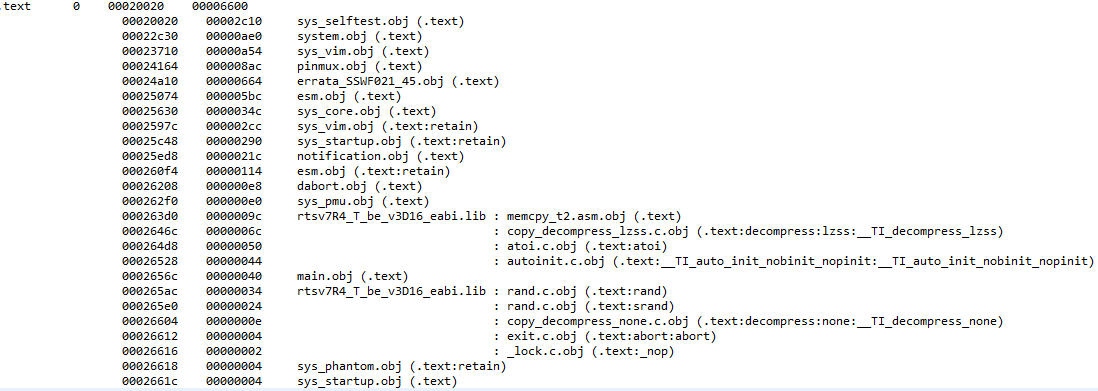

    I appreciate your reply. You are correct in your assumption, I'm using the ROM initialization model.
    Yes, I have reason to believe this step is not happening. Looking at my .map file, I see that _nop is mapped to 0x0056367. So naturally I would expect the value of _lock and _unlock to be 0x0056367.
    But as I mentioned, both are initialized to 0x0. Could CLINK perhaps force these to be ignored? I've tried disabling CLINK but that's not an option for ELF outputs, which is my case.
    One thing I've noticed is that in my "well-behaved" app, the barebones one that just calls srand(), has an autoinit.c.obj that I can't find in my "badly-behaved" app. How do I know for a fact that my variables are being properly initialized just by looking at logs?

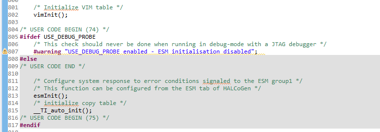

    I think I'm closer to figuring this out, following your comments. Looking at sys_startup.c, generated by HalCoGen, I see that we have the following:
    This #define USE_DEBUG_PROBE is necessary for us when we're in a JTAG debug session, which is exactly my case at the moment.
    So it's our fault that we're not initializing the variable, since __TI_auto_init() has ended up in this #else statement. The thing is, we didn't actually place this code in there. It's only when we changed compiler tools option in HalCoGen to generate TI-compiler outputs (rather than the IAR-compiler outputs we had been using before) that this __TI_auto_init() function was appended to the code.

  • Hello again George,
    The plot thickens. I've found that actually moving the __TI_auto_init() function does resolve the issue of uninitialized variables. However, as is common in our world, that problem is solved but another is created.

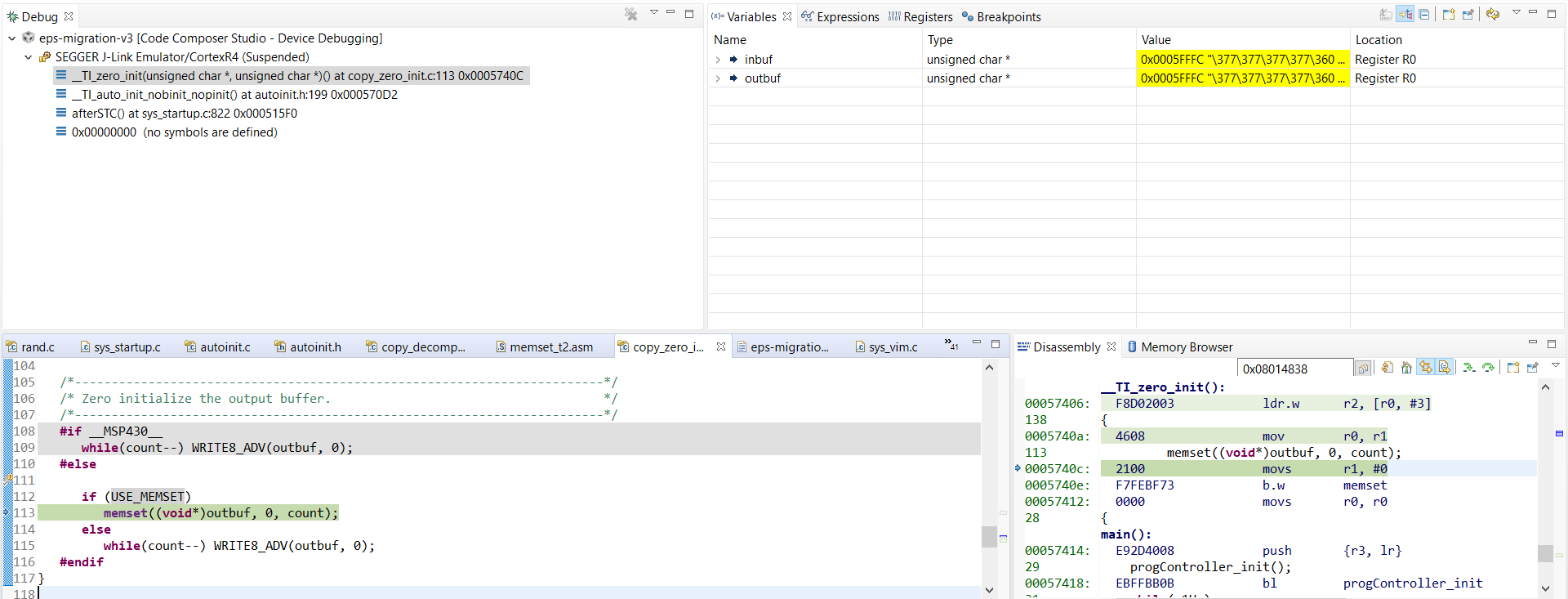

    What I find now is that the zero-initialization of the output buffer in copy_zero_init.c ends up sending my code into an endless loop of memset instructions.
    Since I'm way out of my depth in this, I was hoping you would have some comments, George. I'd really appreciate it.
    Thank you,
    Pedro

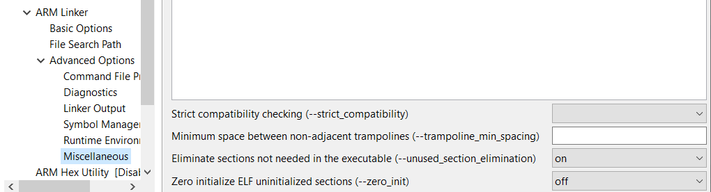

  • Okay, so I think I've figured it out now.
    If I get rid of zero-initialization of ELF uninitialized sections (in the linker configuration) my problem goes away.
    So that's it. It's been a long case and the solution is quite simple:
    - I had the __TI_auto_init() function accidentally commented out in my Halcogen-generated code;
    - I had uninitialized sections being initialized to zero - this messed with the output buffer zeroing function for some reason;
