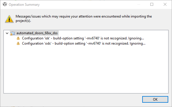

  • When I import the project I get the following warnings. I have tried this in CCS 8.3.0 as the User Guide suggests and the latest version of CCS. The error is the same. I realize it is probably an issue with my build environment, but I am not sure exactly where to start looking.

  • I have found a work around. When I import the MSS project, the DSS project is automatically imported. For some reason this sets the DSS project build settings to ARM build settings which are appropriate to the MSS processor. If I import them separately they build setting are handled correctly.

  • Andrew,
    The issue is specific to importing the projects via Resource Explorer in CCS. If they are imported using the import wizard (CCS menu Project->Import CCS Projects) then it works fine.
    We are investigating root cause and I have filed a bug report. The tracking # is EXT_EP-9655. Feel free to track its status at this link.
