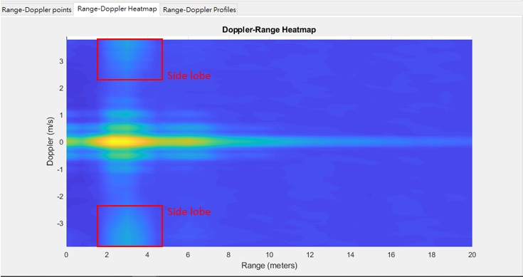

According to our knowledge, the ADC data should be multiplied by the windowing function before 1-D and 2-D FFT separately to eliminate the side lobe level.
There are  windowing types selection for DSP, however only apply for 2-D FFT.
As our knowledge, there is not  windowing type selection for EVE.
So we assume the windowing type is initialized as rectangle window and it is also why we see the high side lode level.
Is there any windowing type selection or setting on EVE that we can use it to eliminate the side lobe level ?
Please help us to figure out this problem.
Thank you so much.

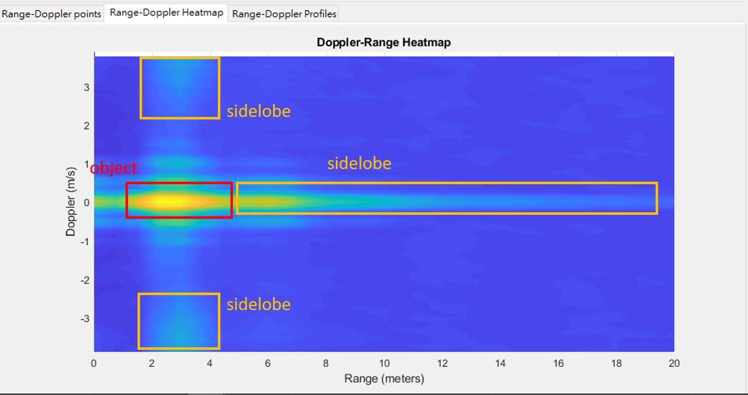

  • Hi Gaviraju,
    Thank you for your replying.
    And we are still confused why the side lobe level in the both end of doppler axis.
    As our knowledge, it seems that it's not caused by the difference of window type.
    Thank you.
    Jacki Hsu

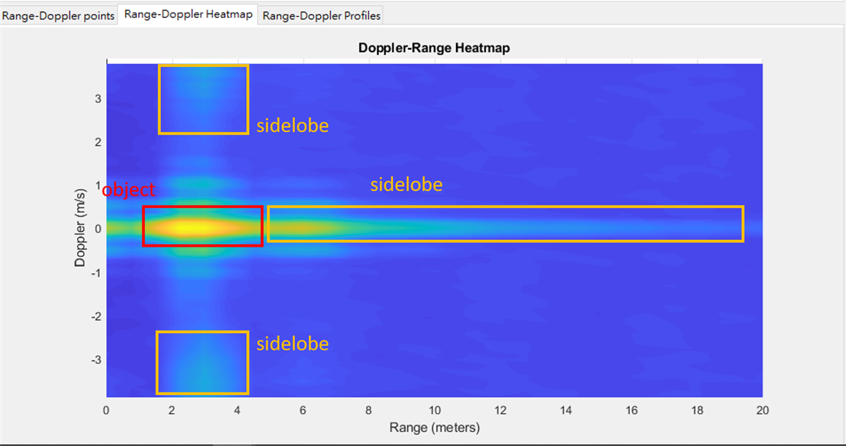

  • Hi Jack
    You can choose which windowing operation you would like to select by defining your own gFftWindowx and then pointing the EVE algorithm code to take this as an input as shown in ChainsCommon_ar12xxSetFFTParams.
    You can see if the windowing is taking effect, by first setting enableWindowing = 0 and see the output and then enableWindowing = 1 and then see the output again.
