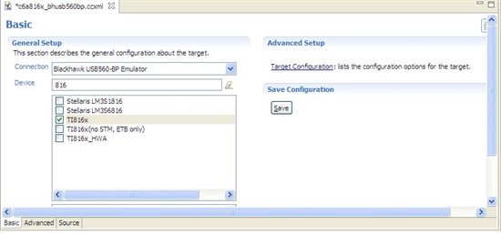

I am also trying to get my emulator to work with the C6A816x/AM389x Evaluation Module.
I am using a Blackhawk BH-USB0-560BP emulator.
I have downloaded and installed the windows version of CCStudio v5.0.2.
I don't see the C6A816x listed as a device in the lists.
What 'Project Type' do you select?
What 'Device Variant' do you select?
Lyndon
If you are creating a CCS project for the C674x DSP, then choose Project Type = C6000, and under Device variant choose Generic C674x Device. If you are creating a project for the Cortex A8, then choose Project Type = ARM, and under Device variant choose Generic Cortex A8 Device.
Before connecting to target you also need a target configuration file. When creating a new target configuration file, select your emulator under Connection and select TI816x for Device (see screenshot below).
Hope this helps.

>TI816x not listed
TI816x is found under the Device listings with target configuration. You must use CCS5 with the c6a816x/am389 EVM, according to Spectrum Digital CCS4 will not work. Also, it is my understanding that you cannot use DSP/BIOS 5 with the 8168, need to go to SYS/BIOS 6. No more .tcf files.
