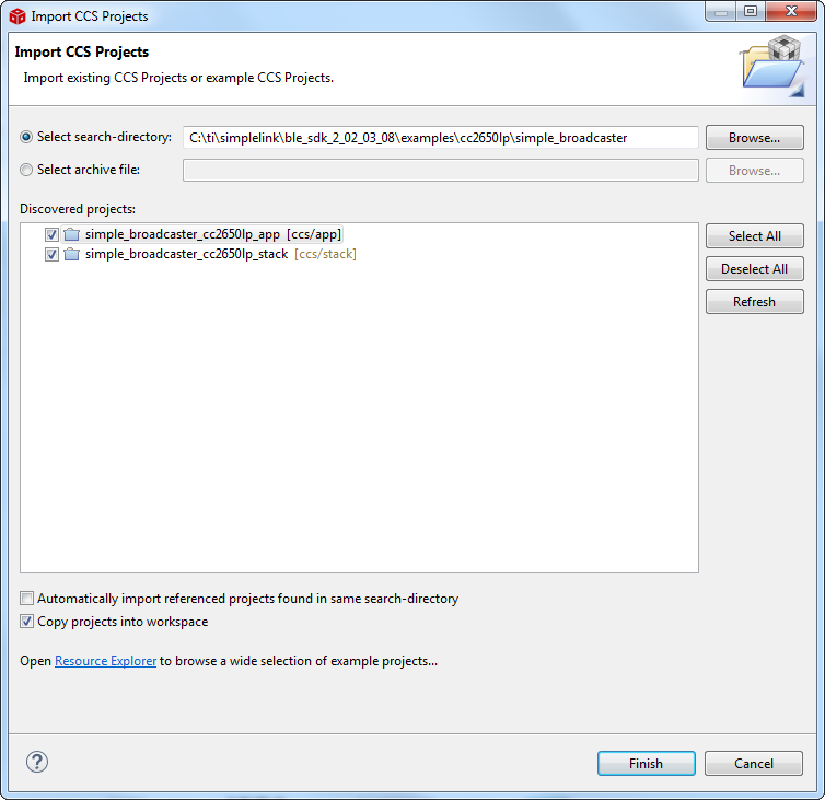

I have been trying to get an example running on the CC2650 module through Code Composer Studio. The documentation for the part leads me to believe that it is very simple to get started and all I have to do is open a new CCS project, import the example I want to run, and then click debug and the code should be uploaded to the board connected to my computer. The steps do not mention that the XDC folder needs to be imported and to find where the ti/bios file is located and manually importing that folder as well. If I did not import the folders, I would get errors stating the files could not be found. Additionally, I am getting a lot of error 1 and error 2s.
Specifically, I have imported the app and stack folders for the simple_broadcaster example in the ti/simplelink/ble_sdk/src/examples/simple_broadcaster/cc26xx. Then I have imported the xdc folder from ti/xdctools/packages. Then when I click debug I am met with these errors.

    I am in the process of setting up the software for CC2650.  You mentioned that you are importing folders into your project.  That seems a bit odd.  Typically you would just import the example project using the import wizard.  There should not be a need to add folders.  I will get the software setup and report back on the steps that I take to import the simple broadcaster example.
    John
  • Richard,
    I installed the BLE SDK.
    Then in CCS I opened the Project Import Wizard.  I browsed to the simple broadcaster example and selected the projects there.  Note that I checked the box to copy them into my workspace.
    After importing them I get a message from CCS that these projects require the TI-RTOS software package for 13xx/26xx.
    I downloaded and installed TI-RTOS from here:
    http://downloads.ti.com/dsps/dsps_public_sw/sdo_sb/targetcontent/tirtos/index.html
    After restarting CCS it detected the TI-RTOS installation.
    I then selected the app project and clicked build.  The project built successfully.  It takes a while to build the first time.  It will also report an error about the fact that these projects were set to use a much older version of the C compiler than what ships with CCSv9.3.
