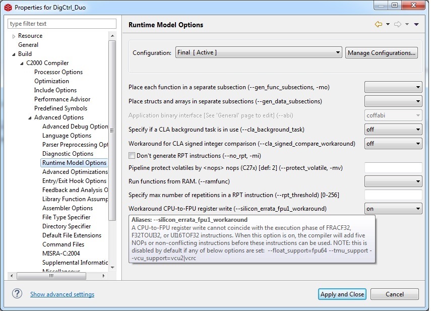

Somehow in realtime control system we notice that the measured is "different" on fast changing signals when using the (float) casts resulting in MUI16TOF32 instructions.
We tried a new compiler and notice that in Version 12.12.5LTS is a workaround "CPU-to-FPU register write (fpu1 errata)" that adds 5x NOPS for UI16TOF32 instructions.
Should this also be the case for CLA-to-FPU instruction MUI16TOF32? This could explain why the optimized float accumulation result (averaging) is different.
    I presume you mean compiler version 18.12.5.LTS.  I presume you are referring to an entry that is filed in our system for tracking issues.  But I cannot find it.  What is the ID of this issue?  It will look similar to CODEGEN-6020.

    Yes indeed, sorry, it's compiler 18.12.5LTS. Its an Advanced Option in my C2000 compiler configuration under 'Runtime Model Options'.

    The compiler switch --silicon_errata_fpu1_workaround is related to interactions between the CPU and the FPU, and not the CLA.
    Is there a pipeline issue for CLA when using UI16TOF32 just as described for cpu->fpu1?
    I don't know.  I'll notify the C28x experts about this thread.
