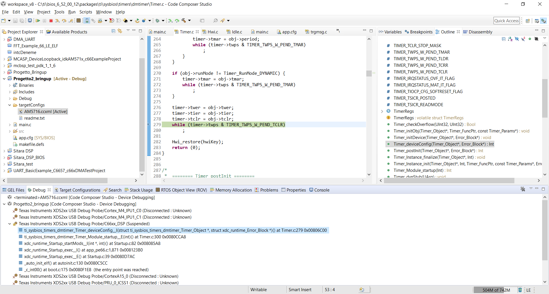

I have created a default DSP project in CCS v8.3 (SYS/BIOS-TI Target Examples-Typical) and I would like to emulate the code with my custom board with a Sitara AM5716. On ARM-A15 runs Linux.
When I download the DSP code, it stops in the following while loop (Timer.c):

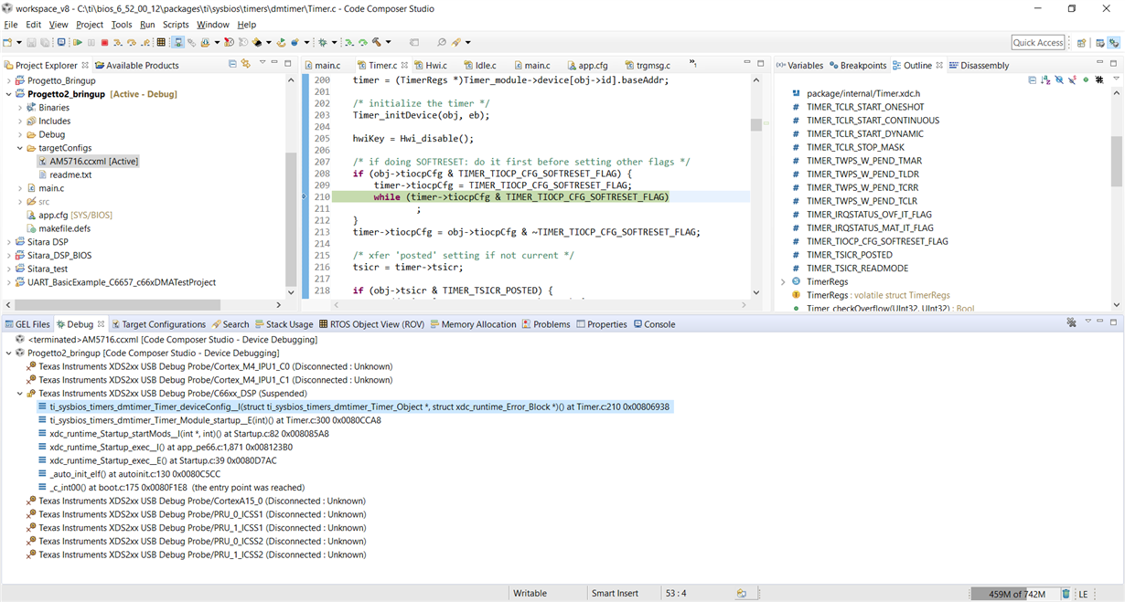

  • Hi Ming,
    you are right, I'm using XDS200 Jtag emulator to download  the DSP binary file (*.out) into DSP C66x inside the SItara AM5716. I follow the procedure in the link to take C66 out of the reset (AM571x_multicore_reset.gel) and simultaneously have A15 working with linux.
    After download the DSP is already runnig, if I suspend the emulation stops like this:
    then if I run and suspend again, it stops:
    Till this point I have many warnings coming from the debug uart of A15.
    After this, my program starts running as I expected.
    I think timer has some conflicts with A15 but I don't know why.
    I don't know If It is clear my problem.
    Francesco
  • Hi Francesco,
    The issue may be related to the DSP accessing the register space of a timer instance Linux has already claimed.  Looking at dra7.dtsi, all 16 timers have been populated.
    Can you try unbinding the associated timer driver on the Linux side, (timer16 used an example below - not sure which timer SYS/BIOS grabs by default).:
    cd /sys/bus/platform/drivers/omap_timer
    echo 4882e000.timer > unbind
    Mike
  • Thank you Mike,
    SYSBIOS seems to use timer5 (48820000.timer). I've tried to write the echo command before the DSP emulation but didn't work. I have to try again but I think this is the right direction.
    regards
    Francesco
