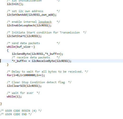

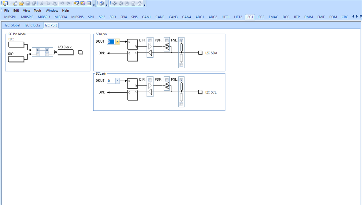

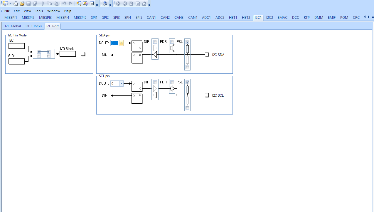

How do I connect an LCD Display to TMS750LC4357, for example to display the temperature from a sensor???
Both SDA and SCL pins must be connected to a positive supply voltage (3.3V) through a pull-up resistor. When the bus is free, both pins are high. I am sorry I don't know the data format required by the LCD. The LCD datasheet should contain the detailed information for I2C communication.
