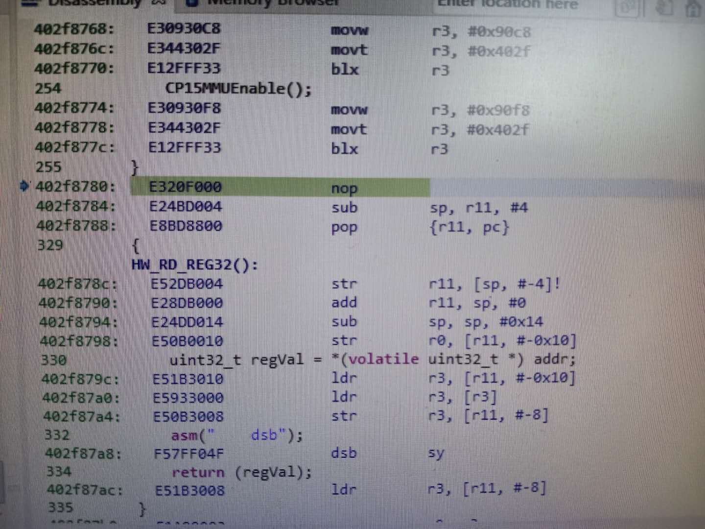

  • In bootloader, I added two api,
    MMUConfigAndEnable  and CACHEEnable, hoping to enable D-cache.
    But when debugging, I found that the program hung up when it was executed to CACHEEnable.
    I don't know why.
    Did you use the following function calls to enable the MMU and D-cache?
    MMUConfigAndEnable(); (defined in C:\ti_am3_610\pdk_am335x_1_0_16\packages\ti\starterware\examples\example_utils\example_utils_mmu.c)
    CACHEEnable(CACHE_IDCACHE, CACHE_INNER_OUTER); (defined in C:\ti_am3_610\pdk_am335x_1_0_16\packages\ti\starterware\soc\cache_arm.c)

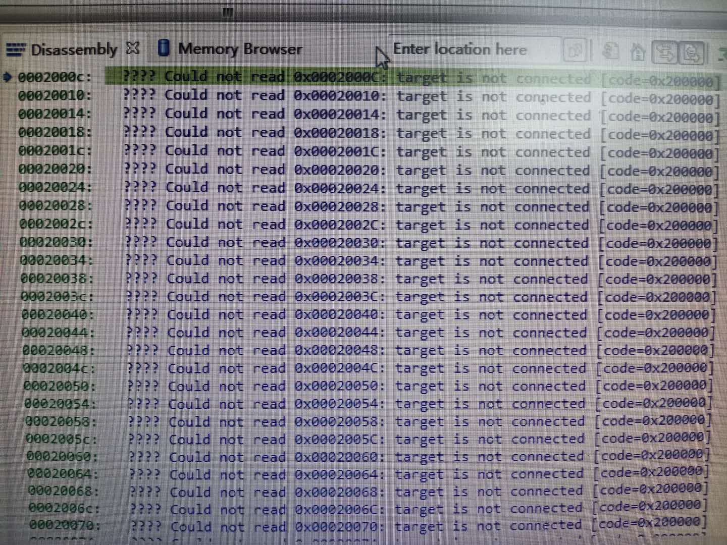

  • Hi Ming
        I have test the read speed by example  :starterware\examples\nand\read_write.
    which use the same nandlib and configure,I tested read 2M bytes,it takes 880ms.
    in this example,it enabled mmu and D-cache,if I disable MMU and D-cache.it takes 16.4s to read 2M bytes datas.
    so I think if MMU and D-cache are enabled,the speed will greatly improved.
    but I failed in enable MMU and D-cache.
        MMUConfigAndEnable()  is the same to ../../starterware\examples\example_utils\example_utils_mmu.c.
    but it hung up when I got to this place.
    when exected this place:
    after this
    it go to
