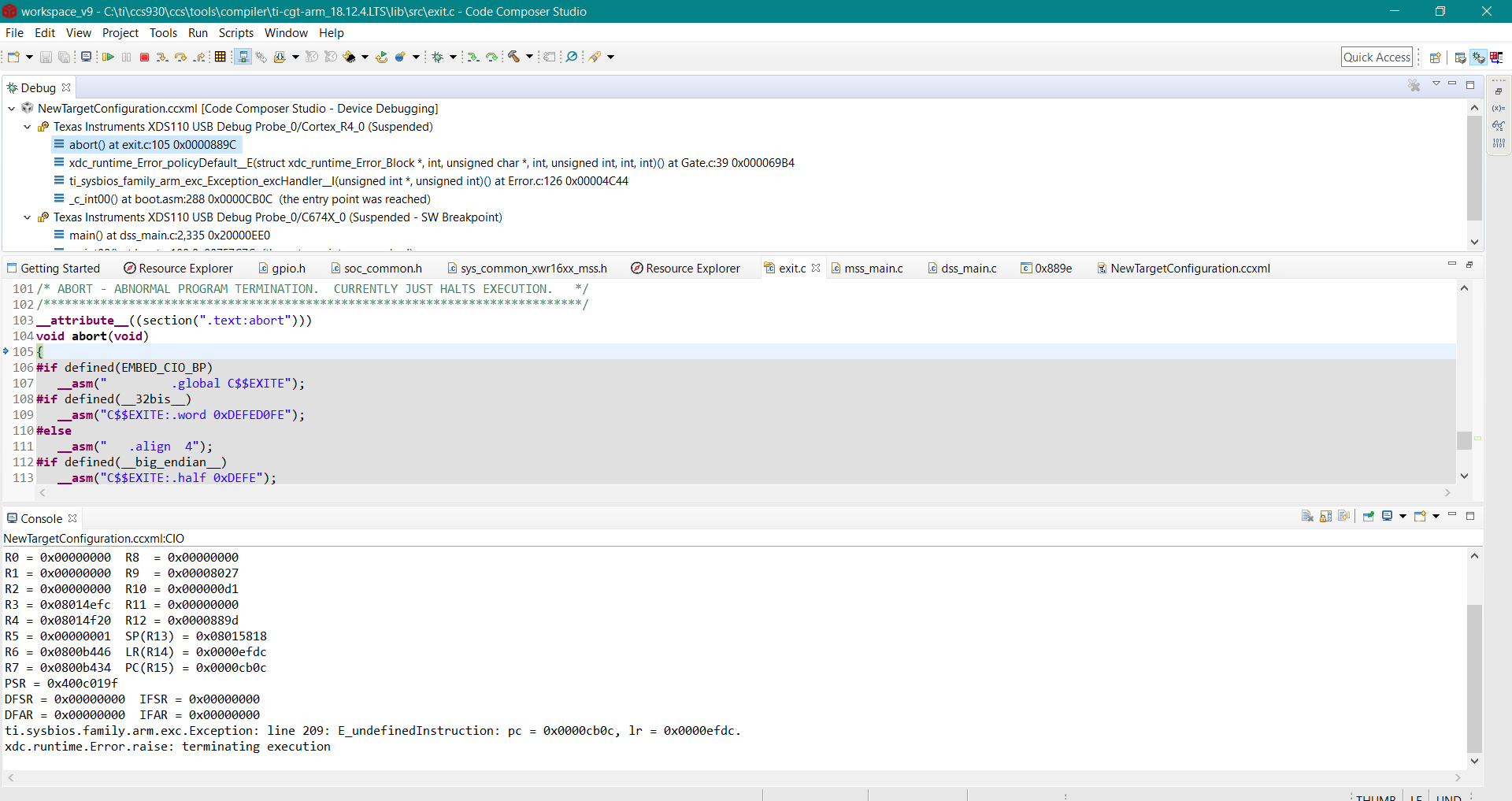

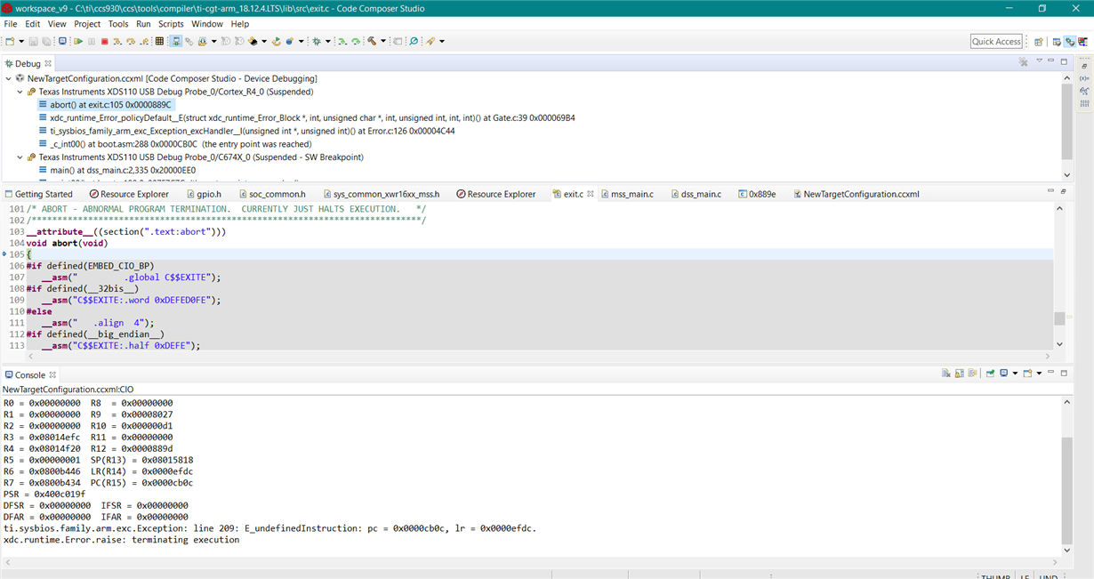

in Code composer studio , i have loaded gesture code which is there for 1642 , which i have modified for AWR1843BOOST,
1> Build project is successful
binary files are also created  after Building both MSS and DSS .
later i tried lauching new target configuration and after launching i have loaded the binary file from DSS which was also successful ,
then i tried to load binary file from MSS during the process it shows error and the code enters Abort and spins forever FOR Loop

    For that error [ Hwi Undefined intnum: 59], you need to execute MSS first then DSS code from CCS.

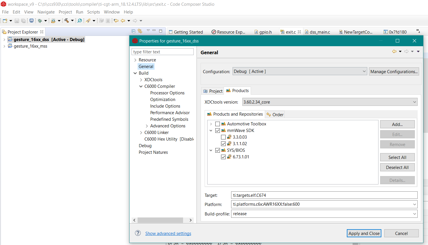

  • could u also share the screen shots of the properties u have set for the gesture project , because i have tried following steps mentioned in document and i m still facing issues , so i want to know the versions of SDK and CCS and also project properties
    these are the versions m using
    Windows 10
    SDK version: mmwave_sdk_03_03_00_03
    CCS:ccs930
    we are working on a POC ,  it would be helpful if u could provide us the exact solution or if we could have a webex session

    As to why the MSS is throwing an error code, we would need to see what the error is.  Very likely, it is a configuration error.

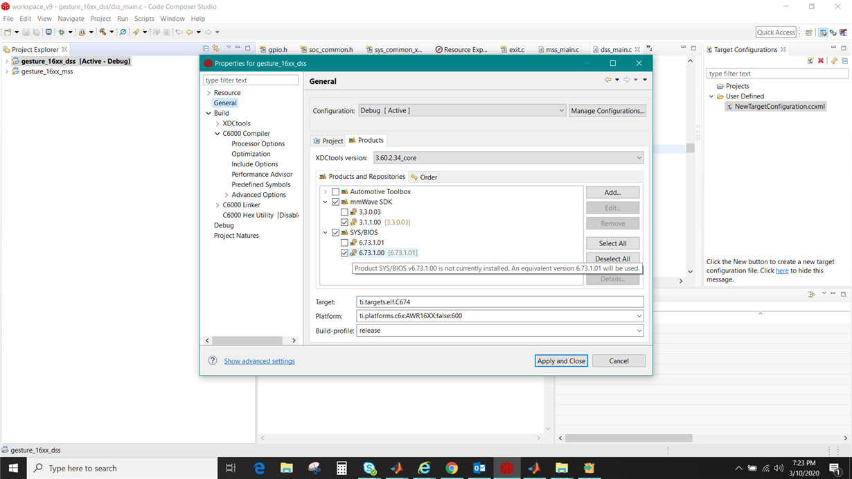

    i have installed SDK 3.1.1. i have this warning is it okay? i haven't tried  yet
  • Yes, it should be fine.  The warning is because the demo's CCS projectspec calls for version 6.73.1.00, and it is not installed.  The SDK's installer will install the required tool versions if you allow it to.

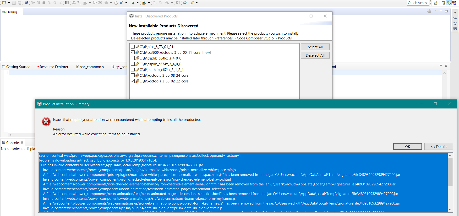

  • i have installed 3.3SDK
    and CCS V9
    separately i have downloaded 3.55.02.22 Core (Windows)   and ltr i m trying to open CCS V9 . i m getting above message
  • I'm not sure what is going on with your environment.  You have said earlier that BIOS 6.73.1.1 was installed, but the message above says either it isn't installed, or has not been "installed" into CCS.
    It is normally best to let the SDK installer install the components it needs to use (unless you're sure that version is already installed).  Then, the next time you start CCS, it "discovers" the newly installed components and "installs" them into Eclipse.  It discovers them because they have been installed into C:\ti.  It should not ask each time you start CCS.
    For the sake of running the demo successfully, I would suggest following Jiten's advice to simply flash the build he created and run the demo.
    For the sake of correcting your environment, I would exit and restart CCS.  Let it "install" everything it finds.  If you get errors, I would delete these components from C:\ti, and re-run the SDK installer.  If you still get errors when you restart CCS, your CCS workspace may be corrupt. The CCS workspace is normally stored under C:\Users\<username>.  You can exit CCS, delete or rename this folder and restart CCS. This will prompt you for a new workspace folder, and then it will auto-discover the components again.  Which should work this time.  NOTE:  If you have any code changes that you want to keep, you will need to save those files somewhere if you delete your workspace. By default, many projects store source code locally in the workspace, and *not* in the original source location.
