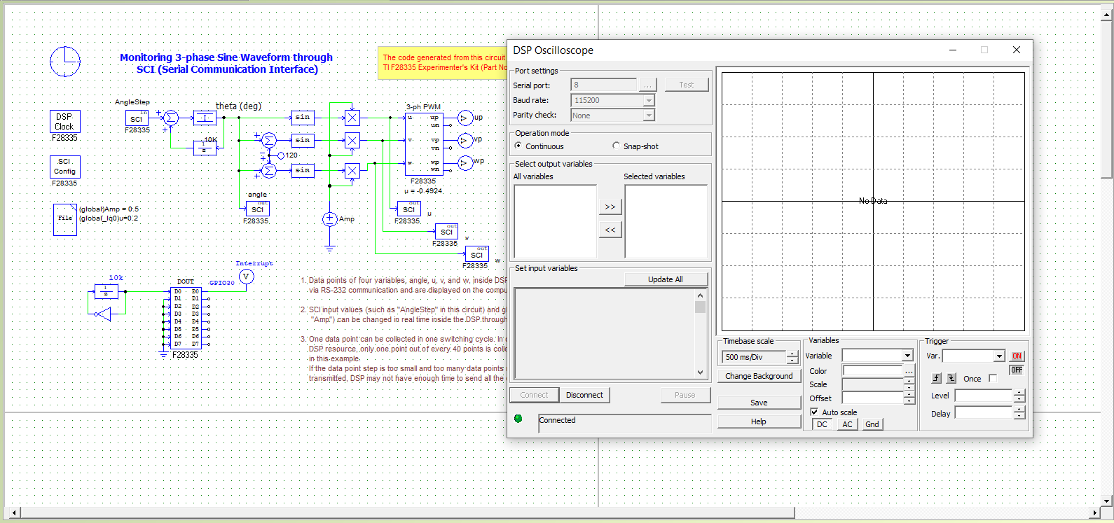

However, the program is running and I test the communication and it give me success. Thus, I go back to PSIM to run the DSP oscilloscope and i connect it with the DSP successfully but it does not show any input or output values at all. Please any ideas or help. I am very new using the DSP board.
Also a picture from PSIM for the DSP oscilloscope
