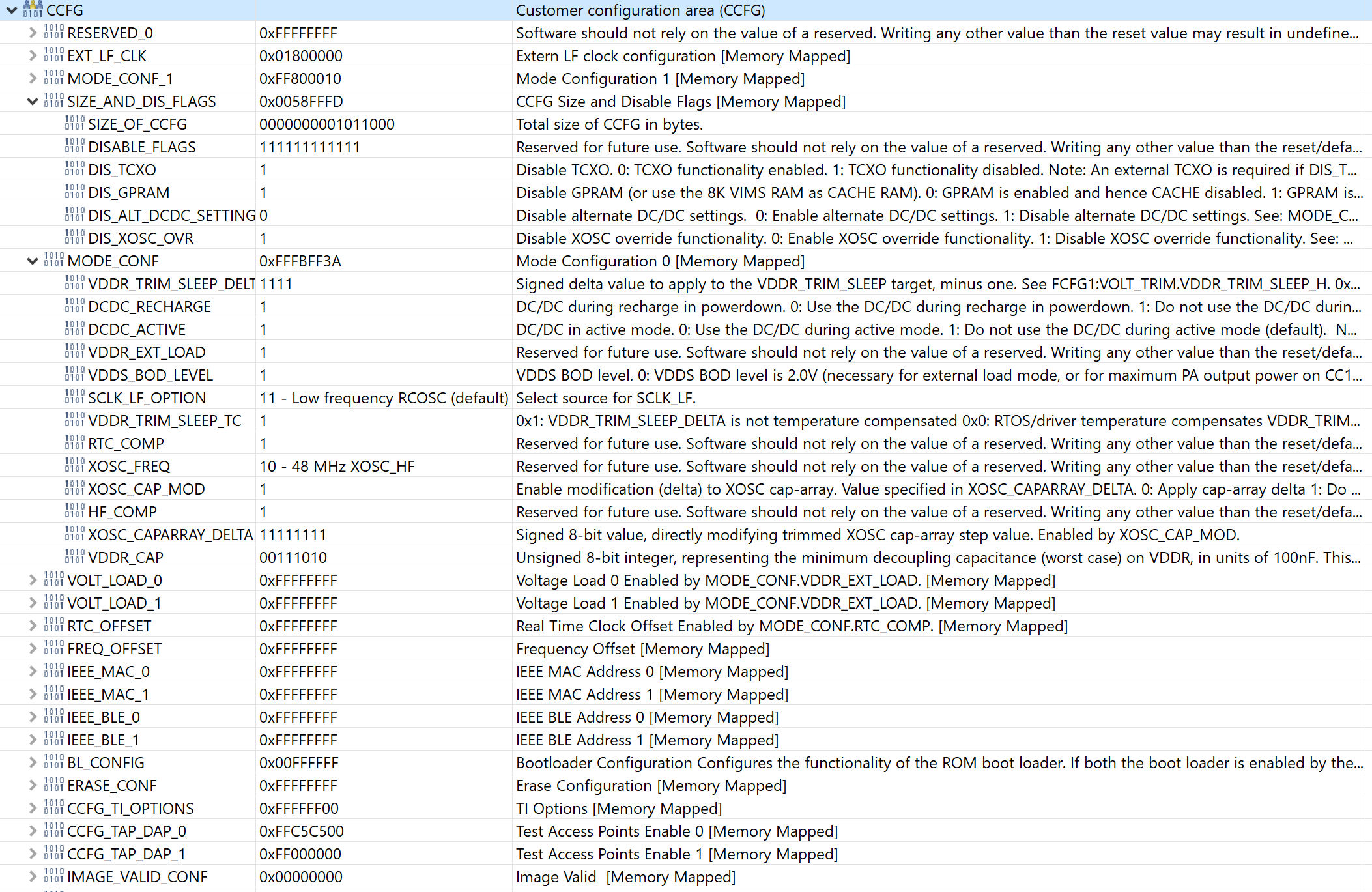

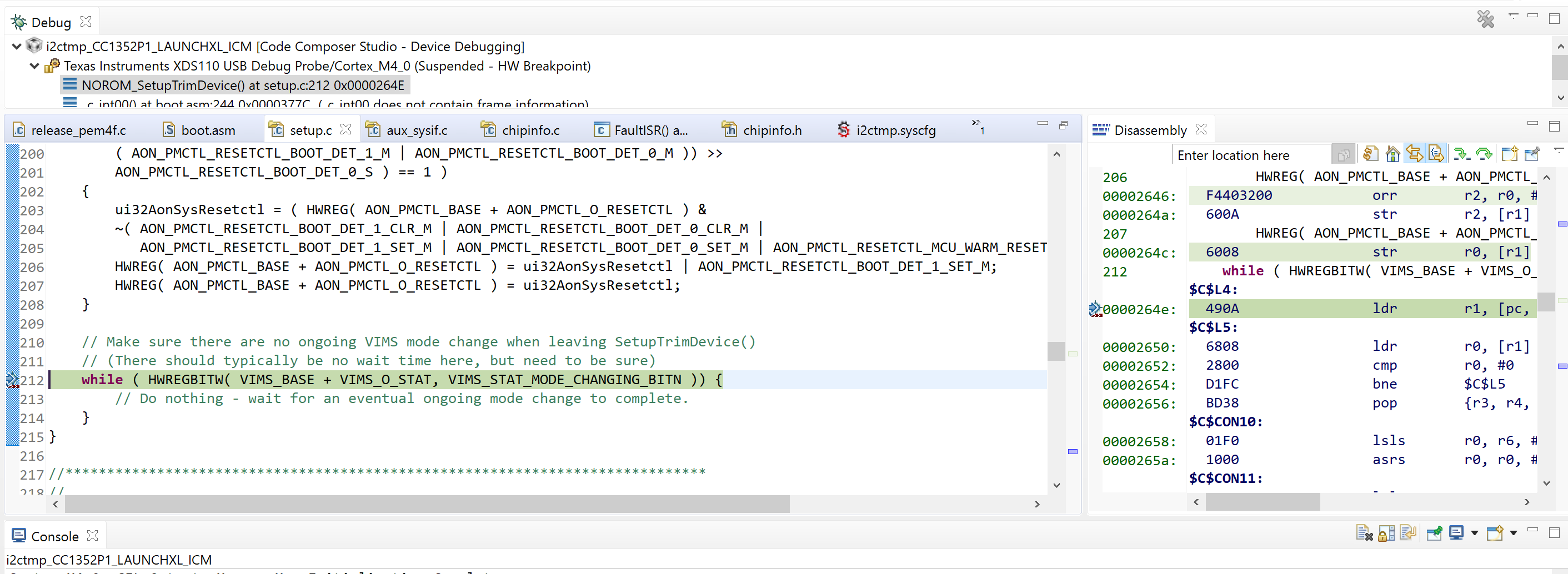

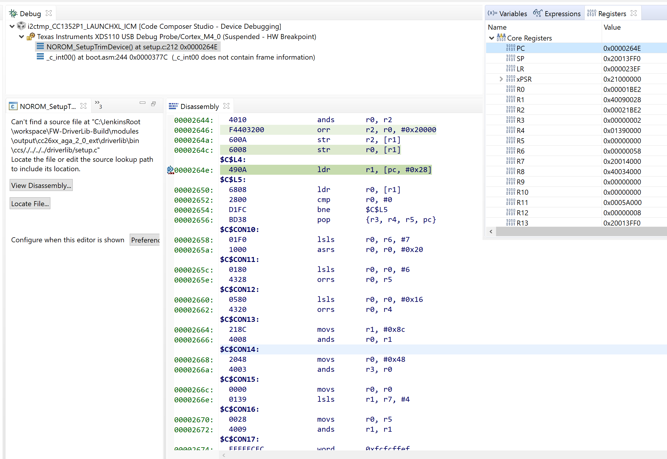

On a custom board, I successfully tested the power and JTAG connection. Unfortunately, when I try to debug code using CCS, I get a hard fault before code execution. In the device configuration, I disabled all modules, except TI_RTOS, GPIO and POWER.
Debugging works on the original Launchpad.

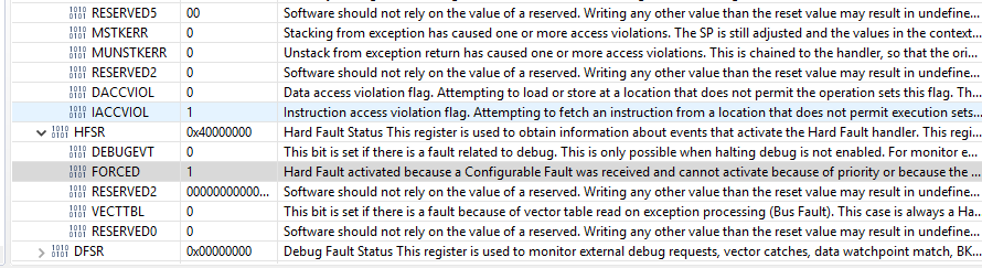

I attached the relevant fault registers.
What could be the causes of this error?
Where can I look further?
