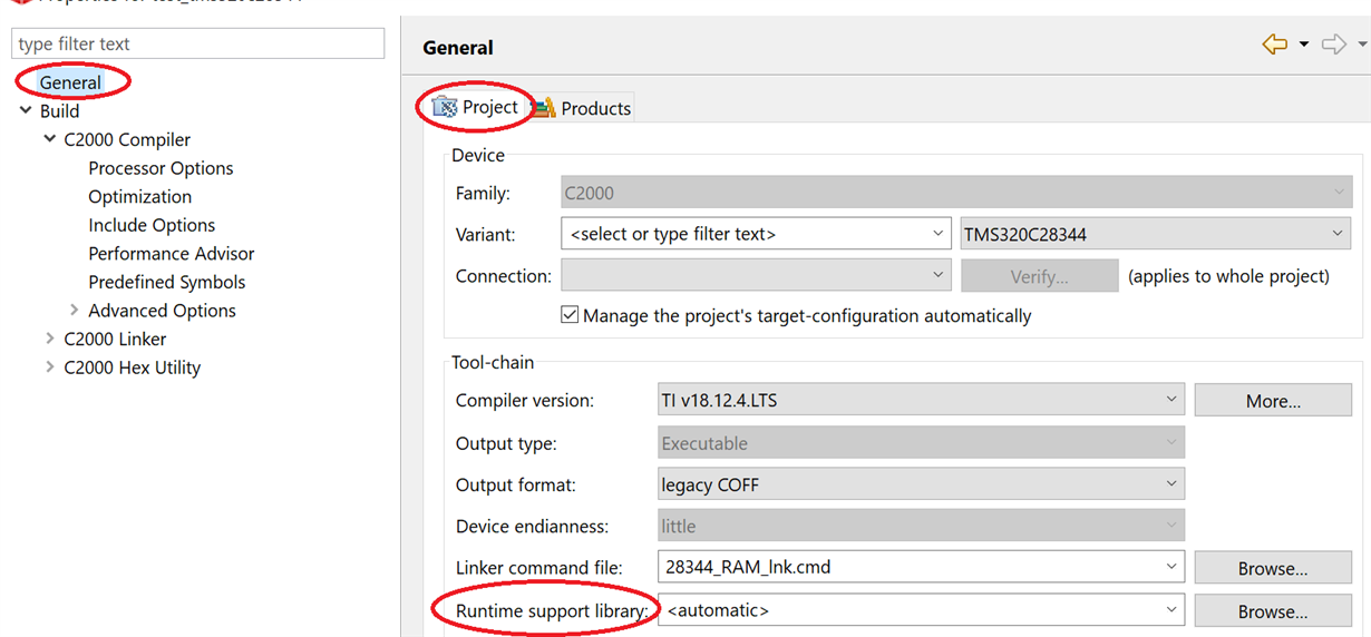

  • Please rebuild the entire project.  One way to do that is to right-click on the name of the project and select Rebuild Project.  Then save the contents of the Console (not Problems) view to a text file.  Use the icon named Copy Build Log.  When you name the log file, be sure to use the file extension .txt.  Please attach that text file to your next post.
    Thanks and regards,
    -George

  • Thank you for submitting the build log.  I see two kinds of errors in it.
    Most of the errors are related to the flash library.  Here is two of those errors ...
    error #16008-D: file "C:/Cerini/Documenti Tecnici/SoftwareVari/Texas Instruments/F28xxx_EEPROM/F280xx/DSP280xx_FlashAPI/lib/Flash2806_API_V302.lib<Flash28_Erase.obj>" specifies ISA revision "C2800", which is not compatible with ISA revision "C28FPU32" specified in a previous file or on the command line
    error #16008-D: file "C:/Cerini/Documenti Tecnici/SoftwareVari/Texas Instruments/F28xxx_EEPROM/F280xx/DSP280xx_FlashAPI/lib/Flash2806_API_V302.lib<Flash28_EraseSector.obj>" specifies ISA revision "C2800", which is not compatible with ISA revision "C2700" specified in a previous file or on the command line
    The problem is that this is either the wrong flash library, or the wrong version of the correct flash library.  To help you work through that problem, I will notify the C28x device experts about this thread.
    The other errors are ...
    warning #10062-D: entry-point symbol "_c_int00" undefined
     undefined first referenced
      symbol       in file
     L$$DIV    ./Source/Function.obj
    error #10234-D: unresolved symbols remain
    These errors occur because the linker does not bring in the compiler RTS library.  Please compare your project settings to the screen shot below.  When you change the setting of Runtime support library to automatic, CCS adds to the end of the linker command -llibc.a.  That  causes the compiler RTS library to be part of the link, and fixes these last few errors.
    Thanks and regards,
    -George
