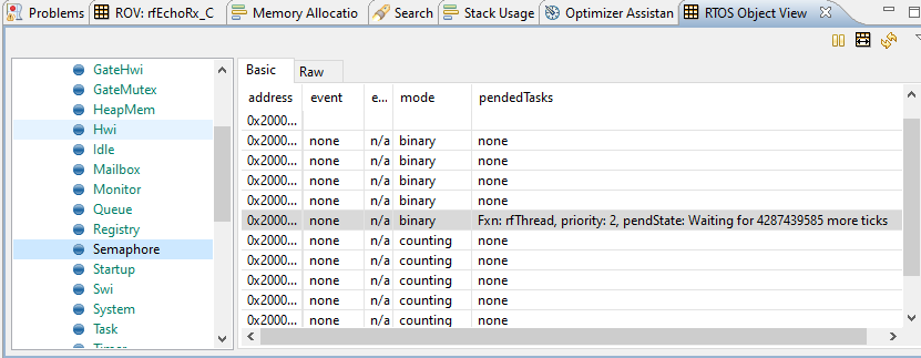

I created 2 threads, one which polls a sensor and another which is a Simplelink RF thread to transmit this data. Whenever the rfThread calls Task_sleep when sensorThread is also calling it, Task_sleep just blocks either very long or longer than specified (in which it eventually returns but took much longer).

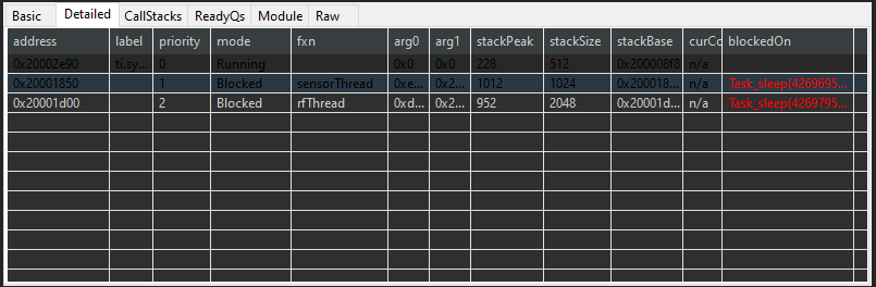

When I remove all instance of Task_sleep in the sensorThread, rfThread works just fine. I saw some online solutions about checking stack usage using ROV, I confirmed there is enough stack allocation. I initiated the threads using Pthread. Any suggestions on how to debug this?
  • Seems like Task_sleep() is passed a very huge value to sleep on, and it seems to happen at random times. What I am actually calling is just this:
    Task_sleep(1 * 1000 * 1000 / Clock_tickPeriod);
  • Switching to a semaphore with timeout yields the same issue, waiting on a large number of clock ticks.
  • Hello You,
    Your SensorThread Task stack ha overflowed. Then all bets are of and your program may crash in any catastrophic way.  Increase task stack size and try again.
    taskParams.stackSize = 2048; // or more. You need to profile and stress test what max will be.
  • Hi Eirik,
    Thanks for your suggestion.
    Is referring to the stackPeak column (see first post) not enough? I set stackSize to be well above stackPeak, and therefore I assumed the problem is not caused by stack overflow. I will still try out your suggestion and try to profile it.
    As a workaround, I used clock_nanosleep instead and so far it worked fine. If it is due to stack overflow, does it means Task_sleep is a much heavier call than clock_nanosleep?
