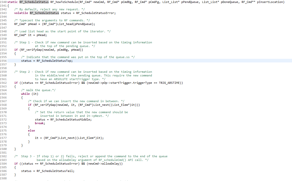

In the code above (step1,2,3)
The scheduling method is based on timing information
What is the timing information here?
Hello User,
Please study the RF_verifyGap function in RFCC26X2_multiMode.c.
It will see check if the new commands can fit in the scheduled command queue based on these parameters:
newCmd->endType
newCmd->startTime
newCmd->endTime
