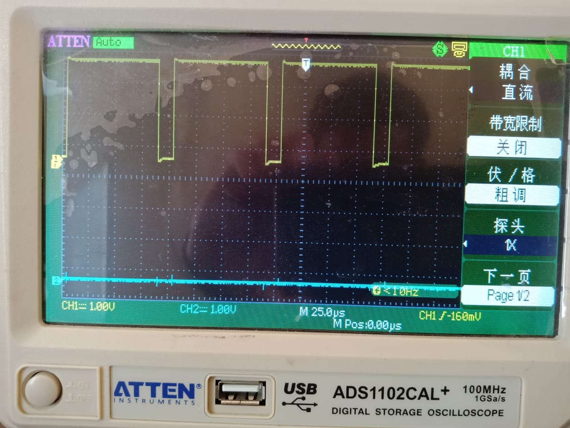

    - Here is the PWM signal applied from the controller on the drive, but from dive to the motor it was wrong as current measured may be 0.08 A in hold state or 0.116 A in normal state when PWM function is not work, note that in 2 cases the signal from the controller not changes.
