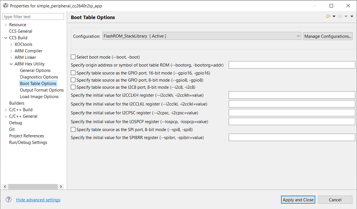

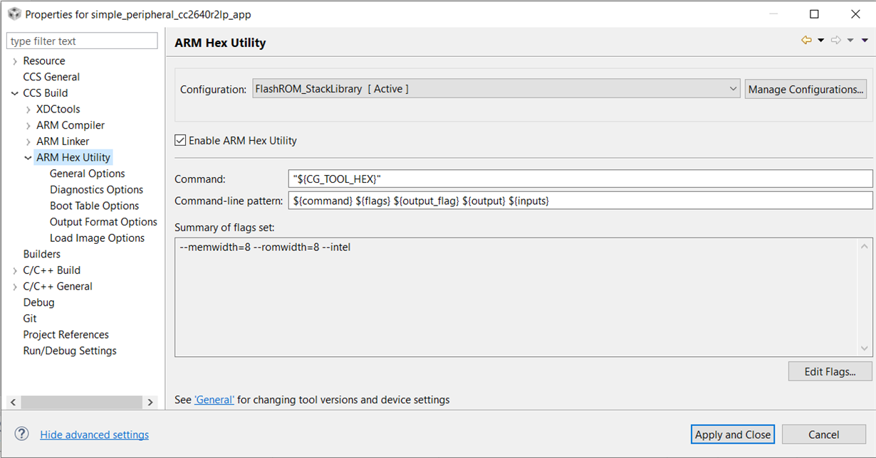

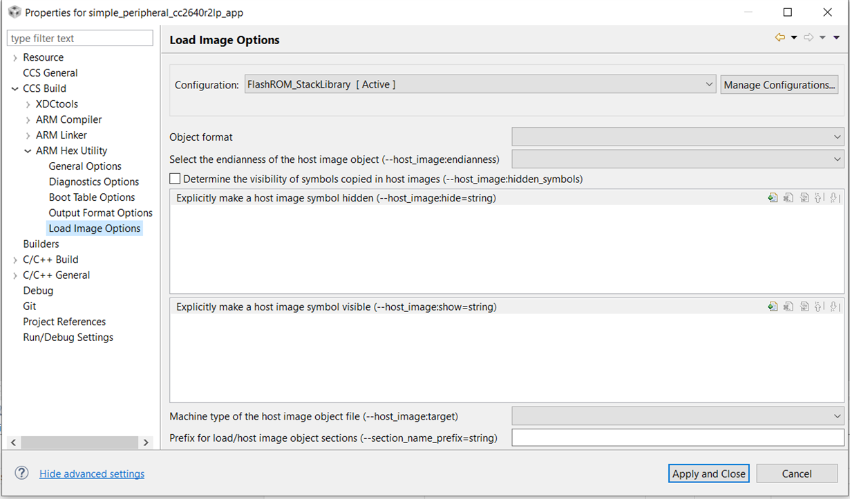

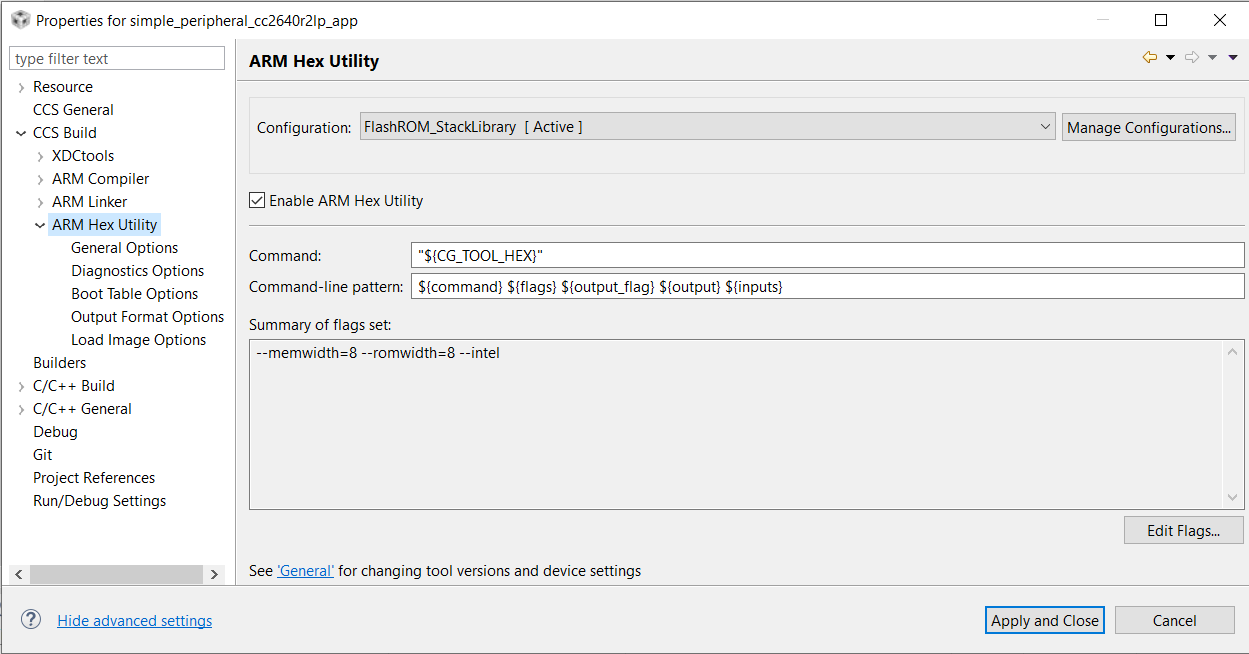

Summary of flags set: --memwidth=8 --romwidth=8 --intel

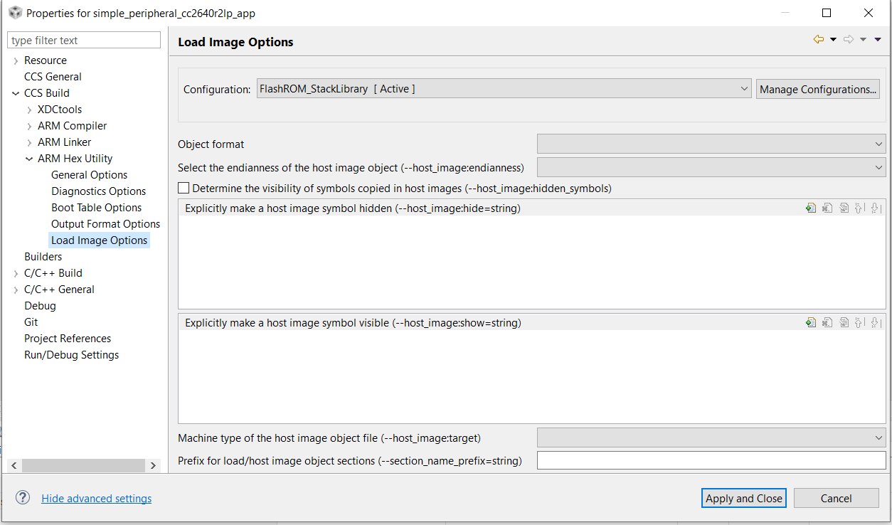

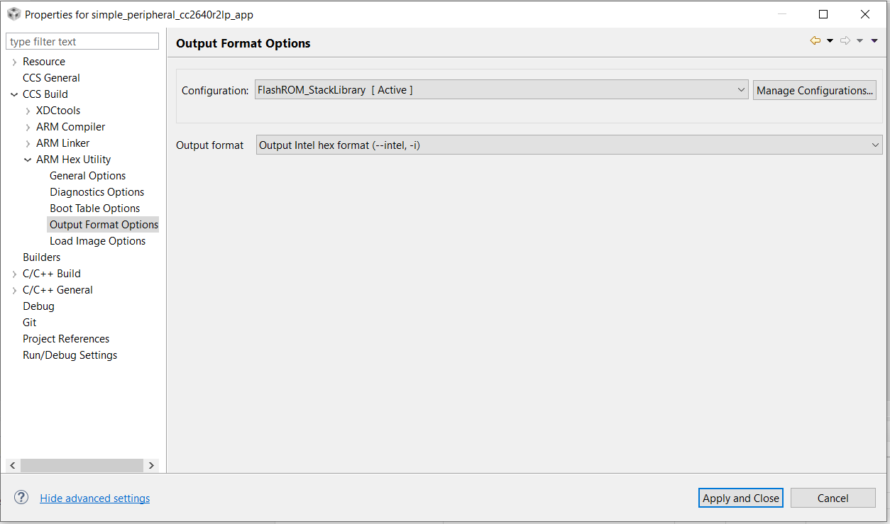

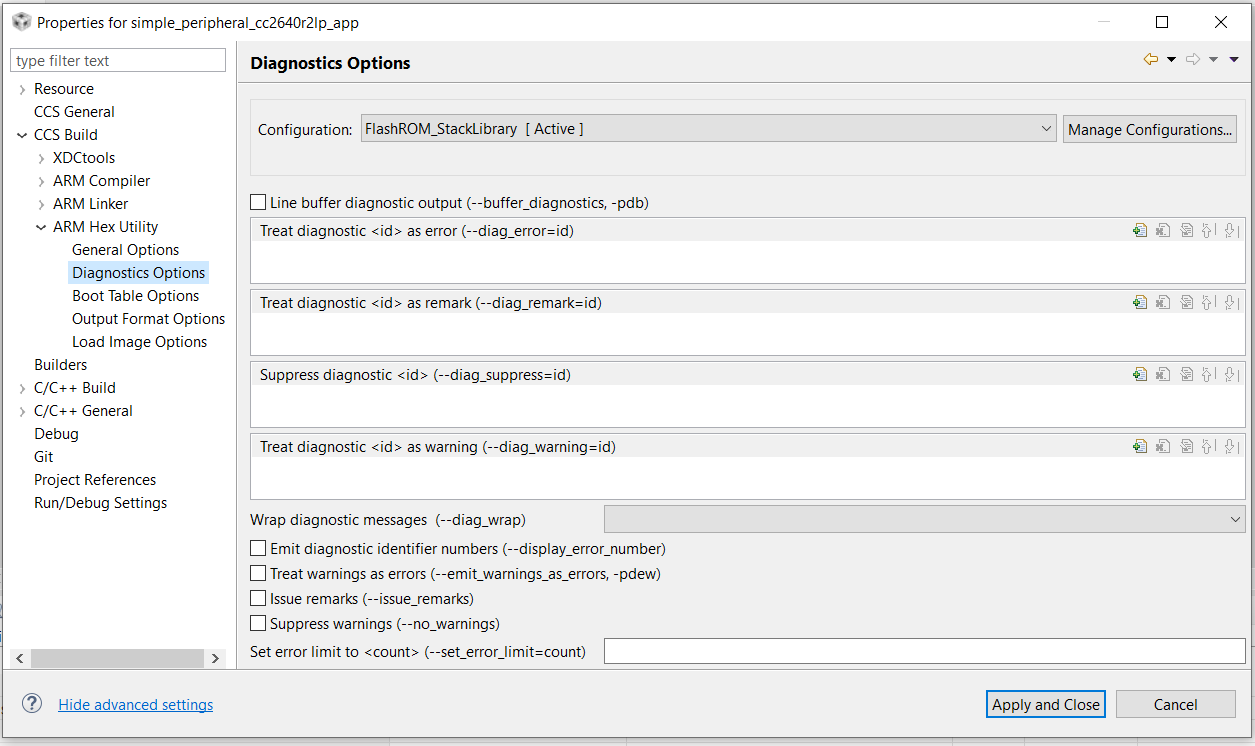

I have included screen shots of the Hex utilities settings pages.
Is there anything else that sticks out as not being configured?

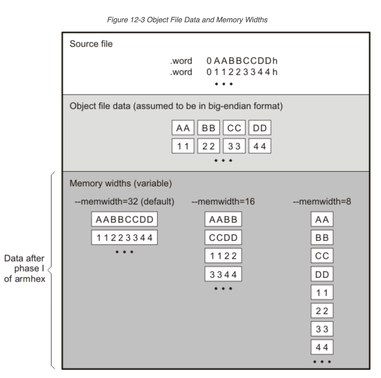

    I asked one of our guys what to use for the hex settings.  He mentioned that the default memwidth is 32 and that would be what he would use.  Does the gang programmer want 8bit?

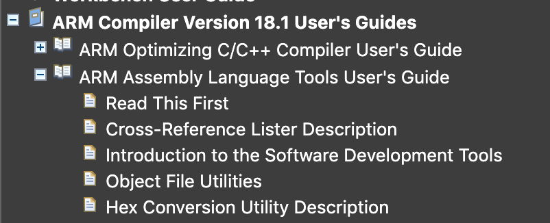

    There is a chapter in the help that has more info:
    That said I am not sure why this would lead to increased power consumption.
