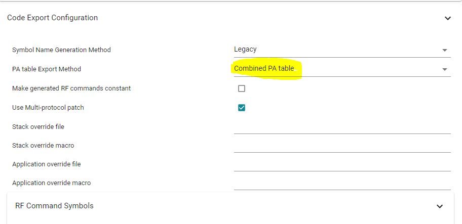

CCS/CC1352P: EasyLink stack requires a Combined PA Table error
Part Number: CC1352P
Tried to change syscfg EasyLink radio Sub 1Ghz PHYs to " 5 kbs, simplelink long range"
PA table export method is set to "combined PA table" , however still get compilation error:
subdir_rules.mk:26: recipe for target 'build-103578833-inproc' failed
error: /ti/easylink/easylink radioConfigEasylinkPhyCustom.codeExportConfig.paExport: EasyLink stack requires a Combined PA Table
1 error(s), 0 warning(s)

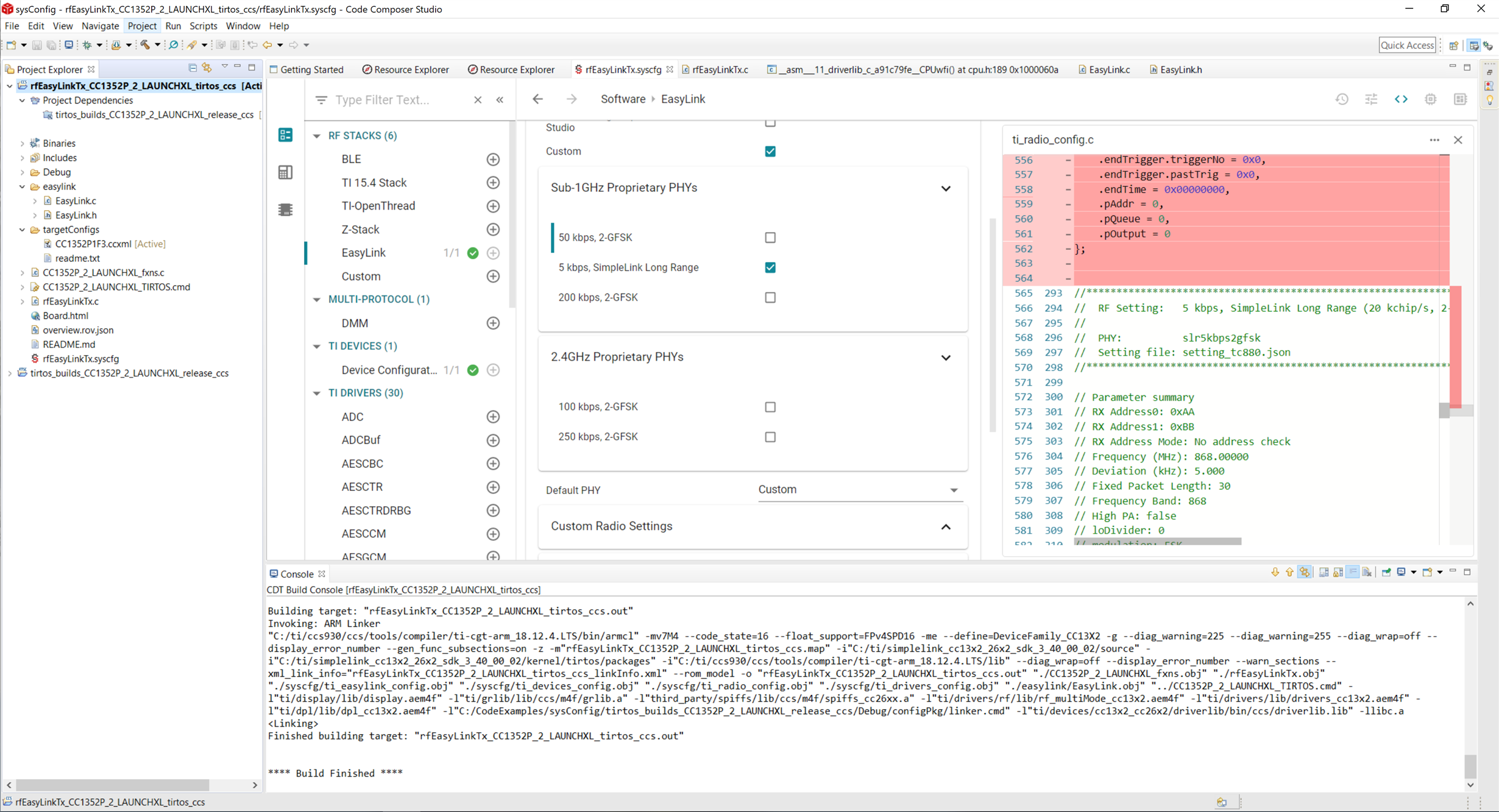

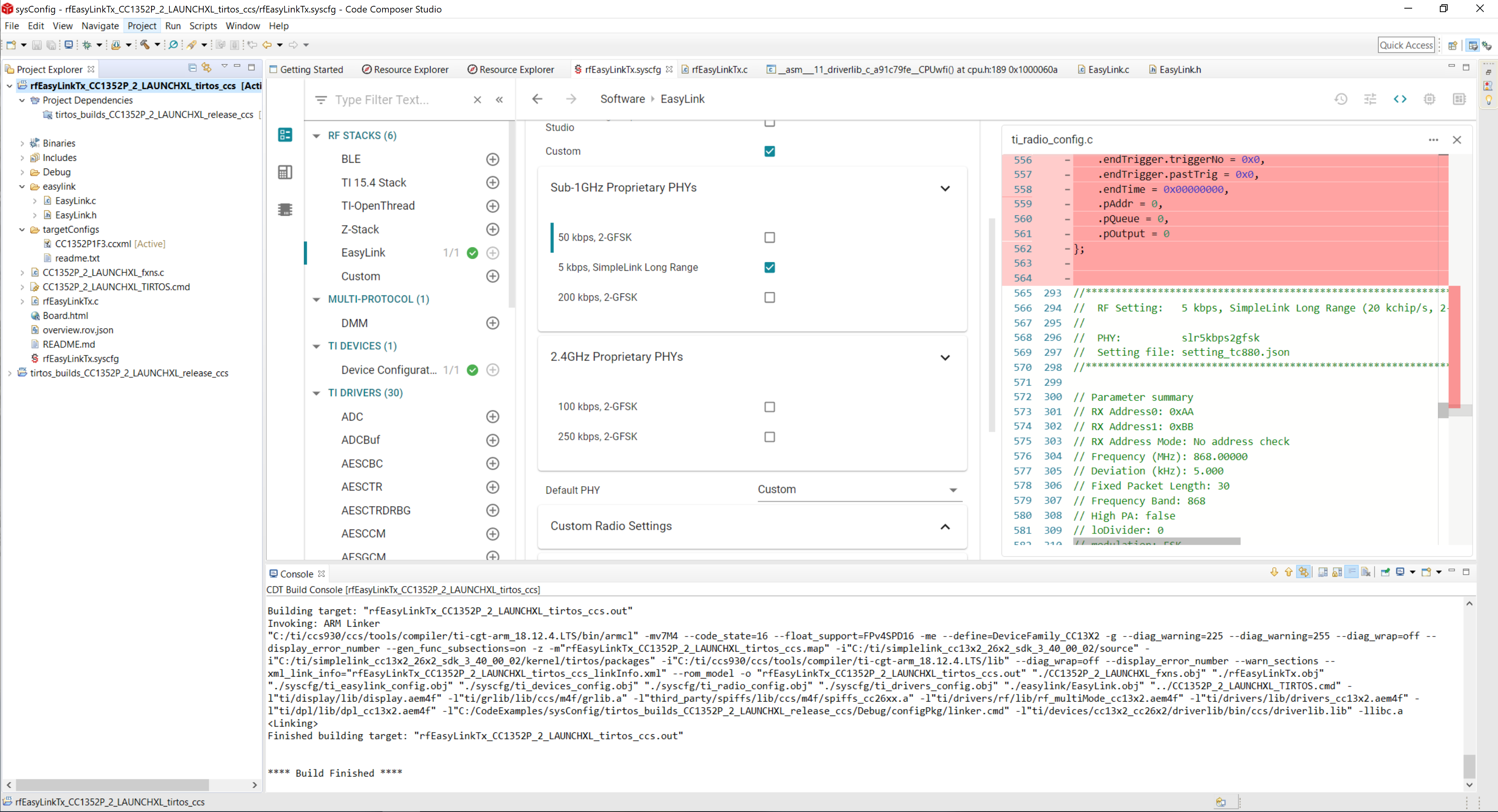

  • I am not sure I understand exactly what you have done.
    I took the rfEasyLinkTx example from the 3_40 SDK (using CC1352P-2) and changed the settings from 50 kbps to 5 kbps SLR by simply selecting this PHY (did not do any other changes):
    The project built without errors.
    BR
    Siri

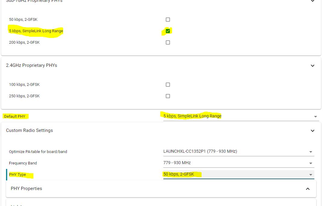

  • Hi Siri,
    Changing the settings from 50 kbps to 5 kbps SLR by simply selecting this PHY on "RADIO" is not enough, and will not actually change the phy.
    You need also to change the "custom PHY settings" to 5 kbps.
    Doing it will generate the error.
    Please double check
