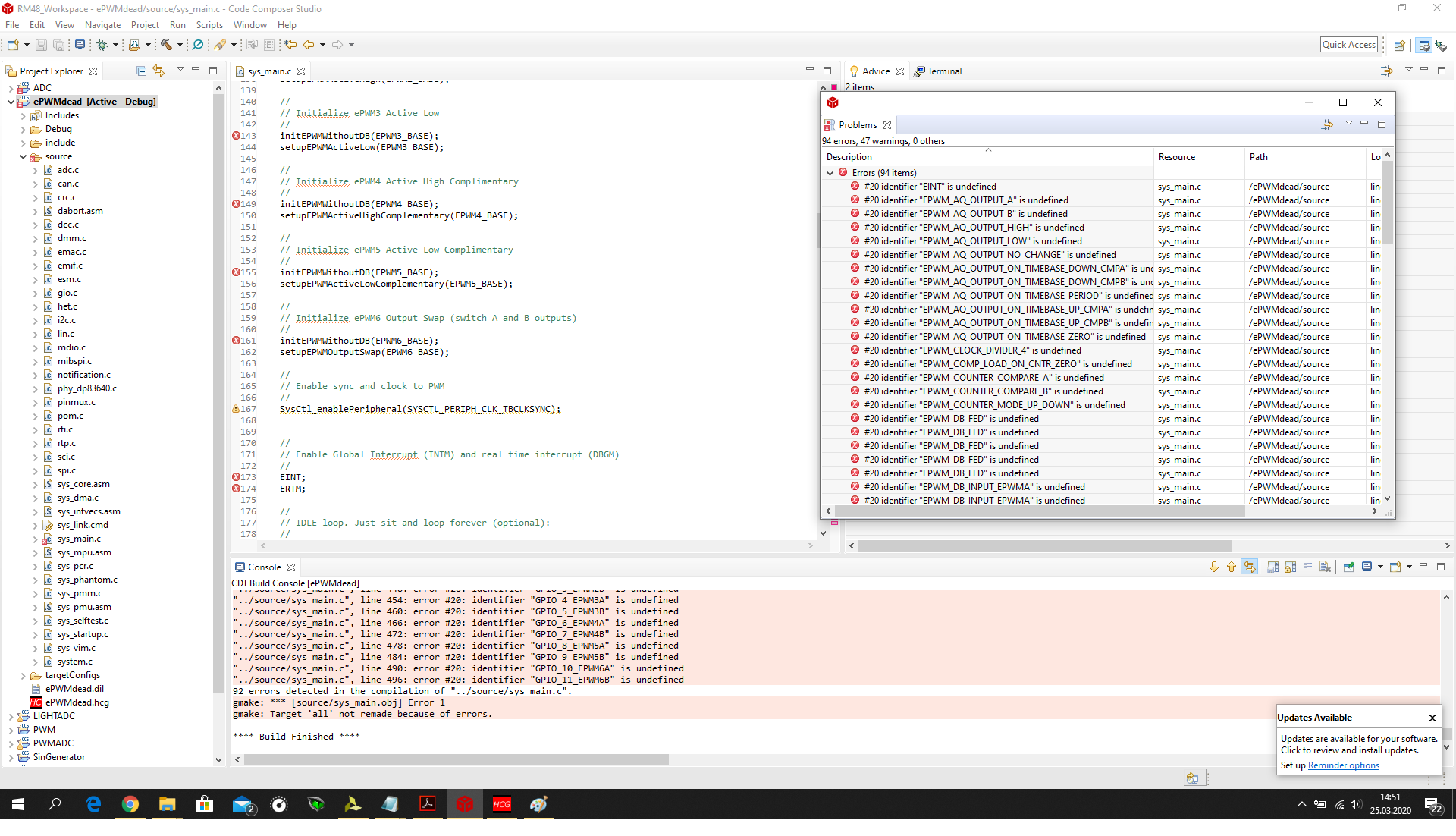

Hello, I try c2000 examples in code composer studio but I get 94 errors. I could make none of them work. What could I do possibly wrong? I changed nothing in the code. I tried with and without halcogen but anyway I get errors.
  • Kadir,
    Please note that Halcogen is for Hercules devices and not C2000.
    The error you have is a result of not having the appropriate include paths in your project properties. I would recommend checking out the examples in C2000Ware for an example of the include and search paths you need to include in your project.
    Ozino
