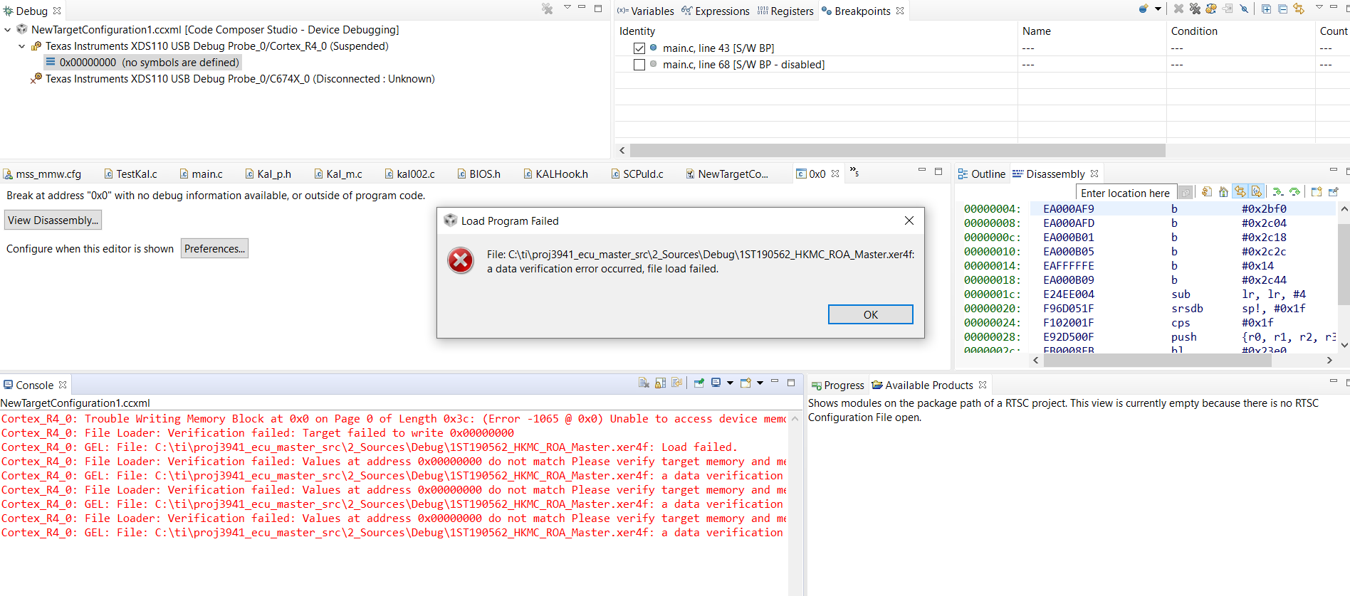

Hello Experts,
I am trying to debug on Code composer studio on target AWR1843 using debugger XDS110 TI ,the options i set are that;
1-  changed the switches on the board to debug mode
2- Created a new configuration file at which i adjust the name of the target and then launch it.
3- Connected to the board
4- And then when i try to load the debug file .xer4f , the following error appears to me (file load failed)
Please tell me how can i solve it and move as iam blocked.

  • Hello Nada,
    I hope you have followed the 'CCS development mode' steps provided in the mmwave sdk user guide to flash the ccsdebug.bin before ccs image load.
    If you followed above step then next suspect is to wrong memory location embedded in your xer4f file, which is controlled by linker command file attached with your application ccs project. Make sure you have selected right options as marked in below snapshot.
    On top of this I would request you to try mmw demo debug images with CCS to confirm all the steps you have followed are correct.
